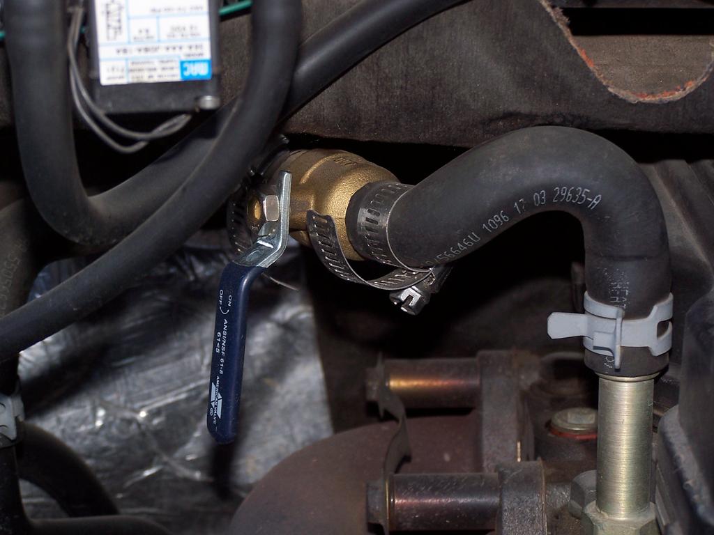

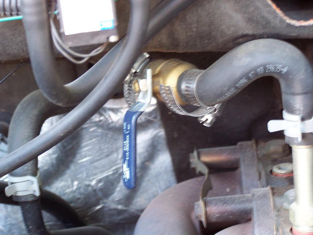

Used this method for two years to make vented air and AC air cooler. Installed a ball valve in line that provides hot coolant to the HVAC box. Line is located on turbo side of engine. I will try to attach a picture.
My question would be how long do the valves hold up.Engine coolant about 200 degrees and most the ball valves that I have seen that had any labeling were rated at 100 degrees
I have used this current valve for two years without any problems. Ball valves used in hot water supplies of most homes are subject to 120 degrees Min. I have inspected the valve each time I have the hood up and found no problem.
Keeping the hot water out of the HVAC box makes the AC more efficient. I could easily put a gauge in the dash vent and test it both ways. I will try to run some tests in a few days, we are due some 90 degree days.
Greatly noticed a difference in the outside vented air with the valve closed. Much cooler, almost the same as the air outside the truck.
I am of the age when you wanted fresh air in an auto you reached down and opened a vent near your feet.
I see two problems here. First, if you want a blast of warm, dehumidified air to clear the windows in a rainstorm, you don't have it. Second, could this cut the coolant flow to the transmission cooler?
Thats good to hear.It may well be a viable option for those of us living in arid enviroments looking for a bit more cool air
I have thought about cutting a small access door on the HVAC box close to where the temperature probe inserts into the evaporator. This would give me the ability to move it to a "Warmer" place on the evaporator but not warm enough to cause the evaporator to freeze up. When I replaced the compressor on my '07, 5.9, I COMPLETELY cleaned out the whole system, replaced the receiver drier, compressor and oriface tube and installed Non Freon, Dura-cool refrigerant and their oil. 100 degrees outside, I see 40-42 degrees at the center vent.

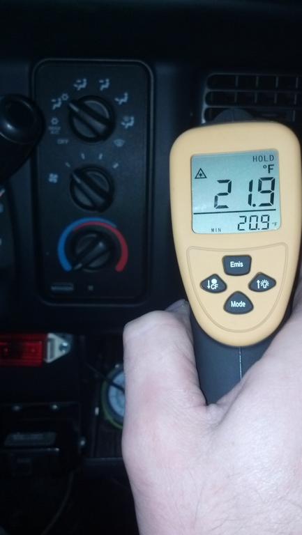

Works pretty good for me. I took this just a little bit ago, 88 degrees with near 100% humidity. Notice the a/c wasn't even on max yet.
The ol' 98's still kickin strong in all aspects.
BTW, I used a 316 SS ball valve that is rated for 300 degrees. They have a surplus of them where I work
Are you using an IR temperature gun? If so aiming directly into the duct won't give you an accurate reading. Still....If you noticed cooler temps then the shut off valve is a success.
It is an IR gun but it also reads ambient temps and I was holding the sensor at the vent outlet to get the reading.
I know 88 degrees isn't hot by some standards and once you approach triple digits or even upper 90's the a/c will not work nearly as efficient but it does indeed make a difference.
