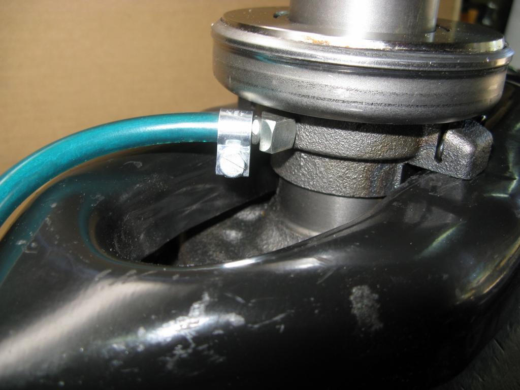

I am replacing ALL the parts in the clutch actuating area so I had a fork and the throw out bearing to work with. I removed my SLAVE cylinder on my truck the other day to see if I would be able to fish out the lube line I am making up to get additional lube to the T.O. Brng. slider. There will be enough room by removing the slave cylinder and give the zirk ONE squirt ONLY. You don't want to over lube the slider so it doesn't get into the clutch. I PRE-LOAD the grease line BEFORE I will install the trans so I know when I put one squeeze of grease into the zirk that one squeeze will go to the collar.
I am going to be the Guinea Pig on this. I am able to work with my friend that owns the trans shop where we are going to replace my clutch. I will report back.

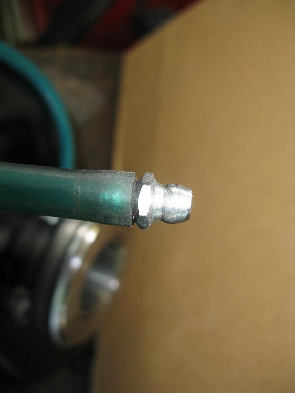

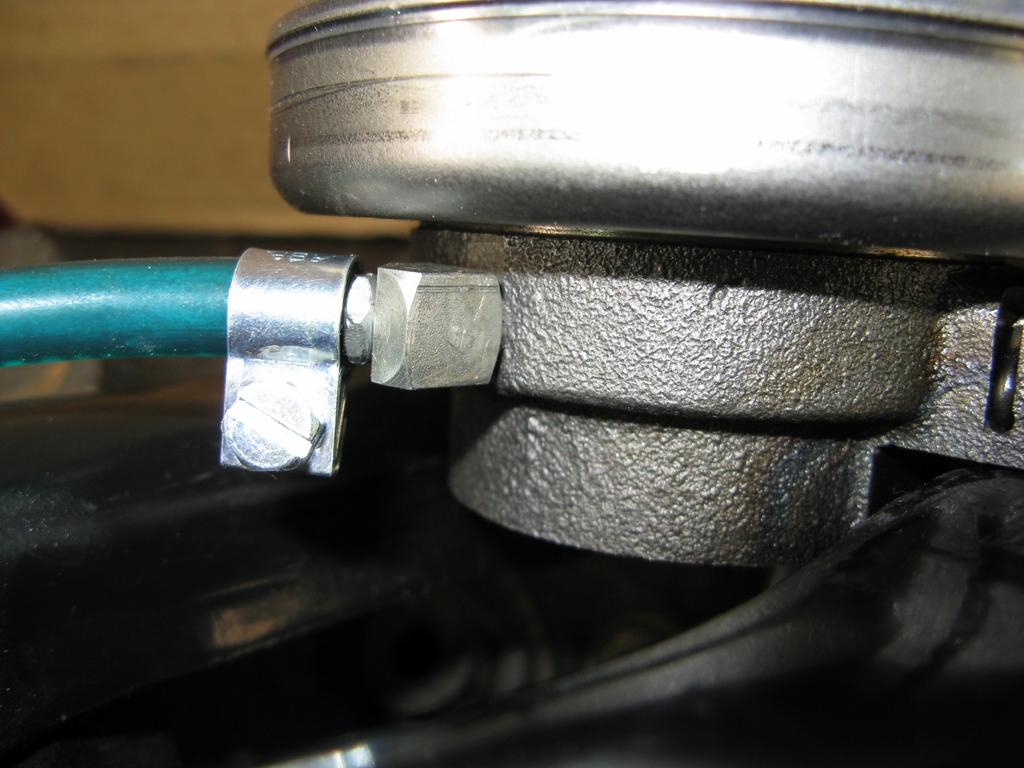

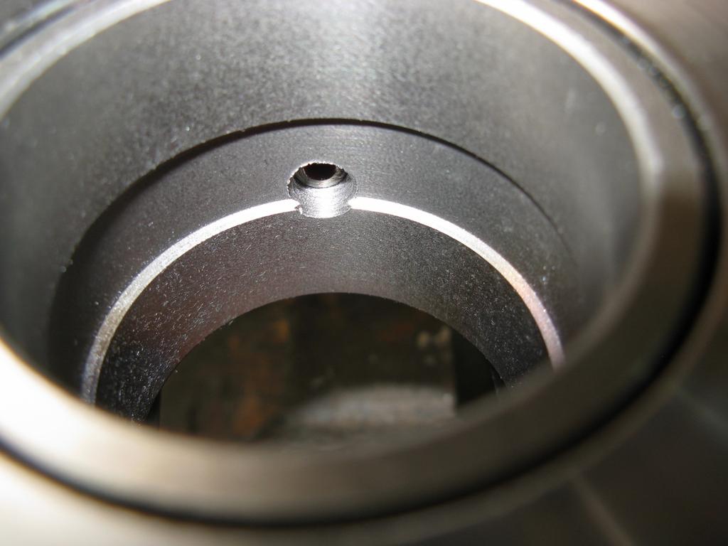

The first picture shows the T.O. Brng. mounted with the hose and zirk. The third will show the grease gun end. I will cut this hose to length and safety wire around the hose where the zirk fitting slips into the hose. The last picture is the bore of the T.O. Brng. where the grease ring is. I used a 5/16-24 tap for the angled zirk fitting.

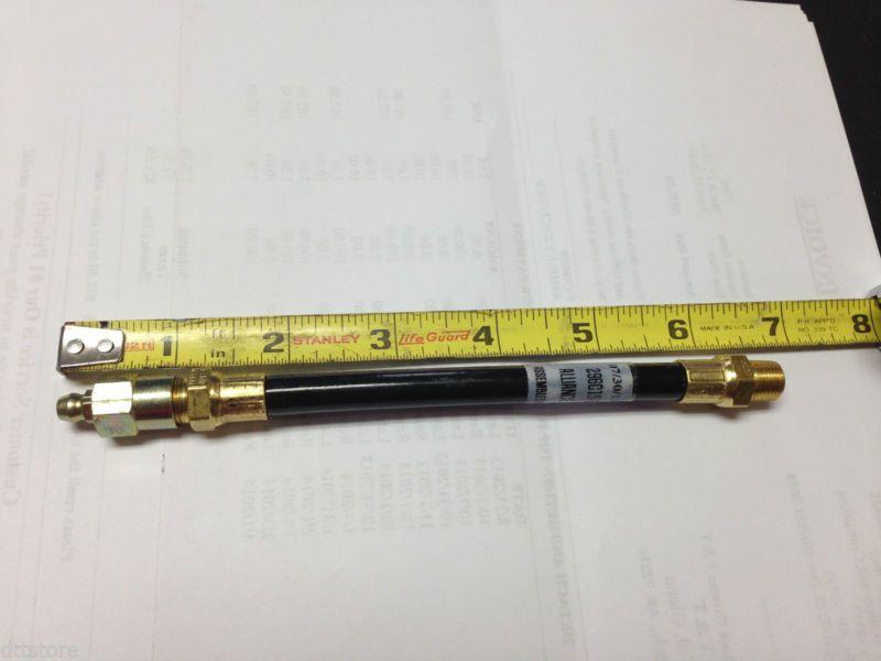

Spicer offers these, custom made for the job. Big trucks all have this...
Available in 6", 8" and 12" lengths. There may be more..
