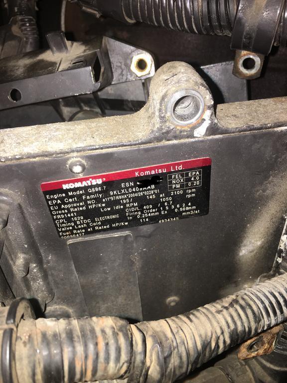

We have a series of wheel loaders that are 2005 ish Komatsu 380-6 powered by what I always thought was a QSB 5.9. They've been good machines, fairly trouble free although perhaps a bit complex with some controls for the guys that use them.

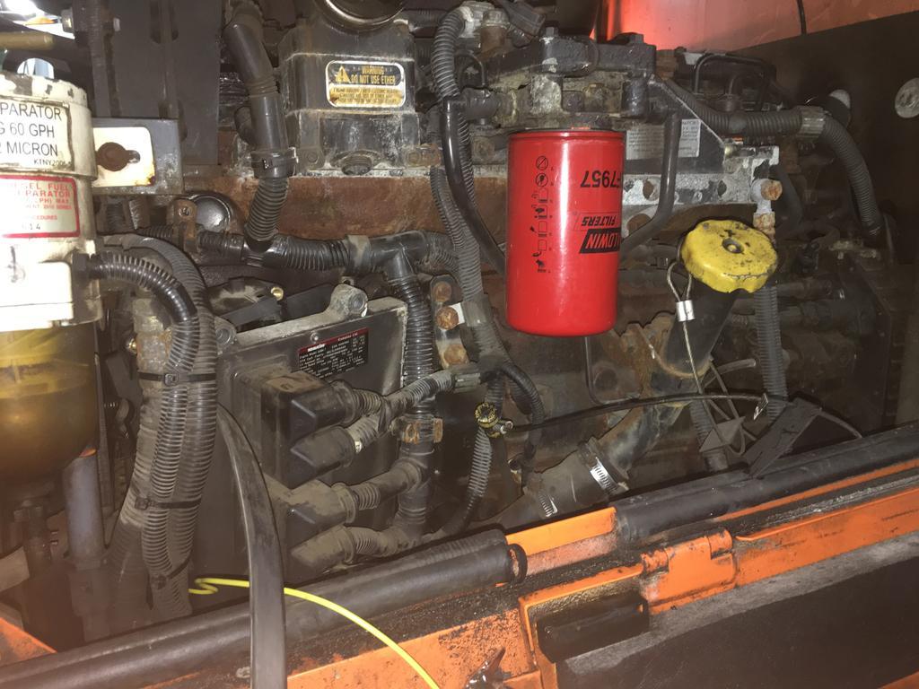

We've been tracking one that's been using enough engine oil to empty its crankcase in a shift.
Once we found the oil fill cap off- AHH! That's it! Nope, still leaking. So after chasing this thing around and getting it in the shop, we narrowed it down to a spot behind a plastic plate that holds the ECM. What could be behind that?

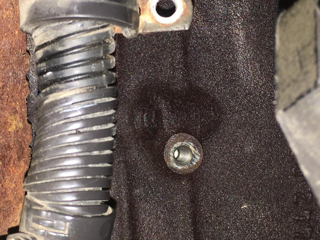

So we dug in, and much to surprise, there is an angled galley that ends in a small expansion plug that's rotted out just below the head! Seems that's it's not full pressure there, but enough to allow a small geyser. We're wondering what this port was/ is used for? And another discovery I made was that this is a QSB (rear accessory drive) but it's a 6.7, a bit before I thought they came out. Do our Ram blocks have this port?
The top image is 90* off. The galley runs vertical.
As I recall there were gallery plugs provided for various accessories. Your application obvious didn't have the need thus the plug?
On our truck blocks there is a notorius plug behind the ecm that was meant for dipstick tubes in other apps.not sure from your pictures where your culprit is located
Yes Bob, that's there. There's a cutout in the plastic adapter plate, and that's where we thought the leak was. It's plugged too. But then we realized the wetness was further up the block. Suspected the mechanical fuel pump block off too, but we started it and that told the tale. This leaker comes out on an angle, vertical, and the plug is a couple inches below the deck.*
I'm assuming it's a leftover from the inline pump days.*
