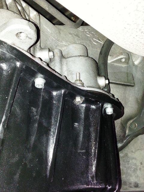

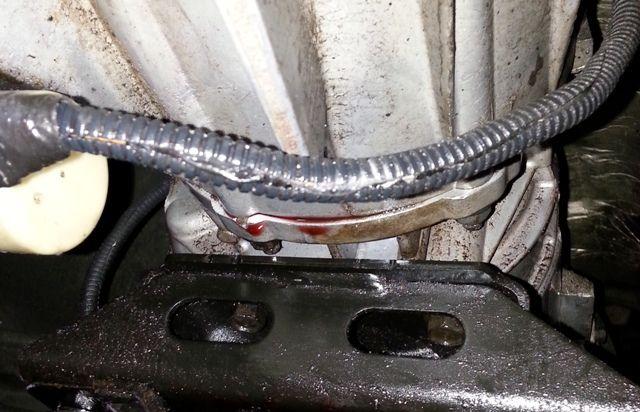

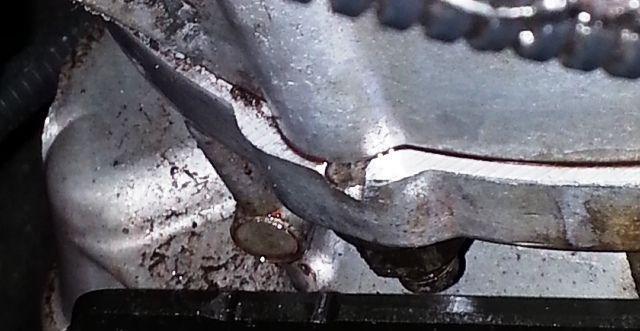

The OD unit appears to have a small chip (bottom LEFT pic) as if it had been dropped. I doubt the casting came this way from the factory.

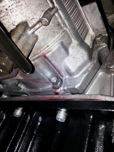

The lower right bolt (Top left pic)) has been leaking for almost a year. I've had the bolt out and back in six times now using various Permatex thread sealing agents appropriate for the application as well as, various sealing type washers. (copper, Teflon, and fiber) Nothing has worked. There is NO sign of cracked casting.
The transmission pan bolt hole (bottom right pic) was also stripped out by the idiots that rebuilt the transmission. I used a 1/4x20 through hole to compensate.

Ir is more likely somebody used a chisel to sperate the OD unit from the case and chipped it. The leak is either case flaw that has finally worked to the surface or a hairline crack that will take some very good instrumentation to see. That is not unusual on these OD units because of the mounting system and the TQ n the drive train. It is so much of a problem PATC is sourcing a heavier custom replacement for the OD houisngs.

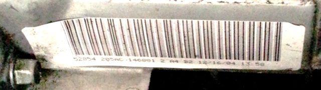

Post a photo of the sticker. It may have a julian date stamp and you could tell if it was built after your truck was.

Post a photo of the sticker. It may have a julian date stamp and you could tell if it was built after your truck was.[/QUOTE]
The door panel label build date is 02/2005. OD unit is 12/04.
