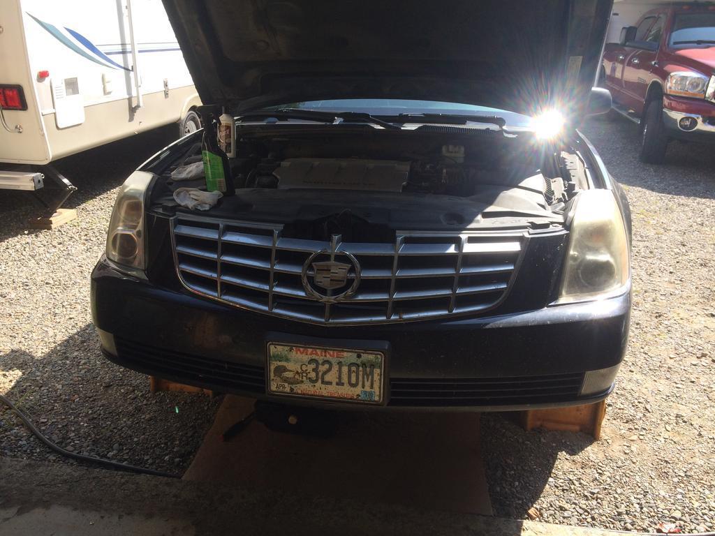

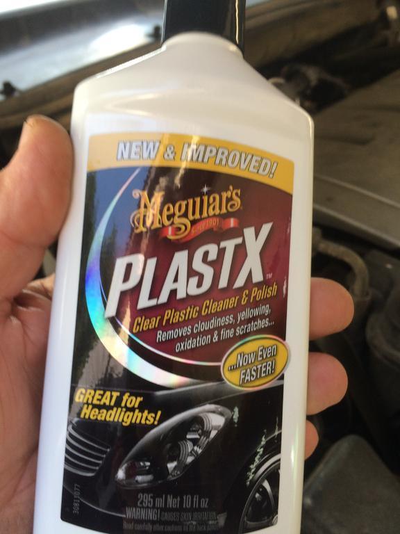

Seth stumbled on to this product at Wally World.

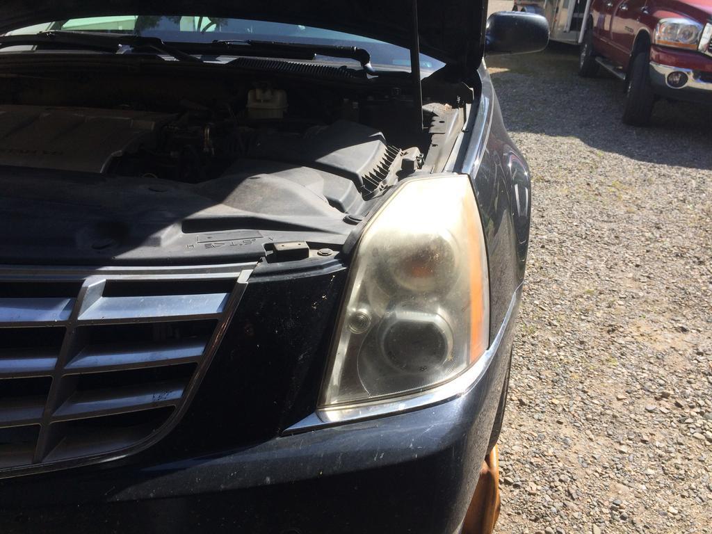

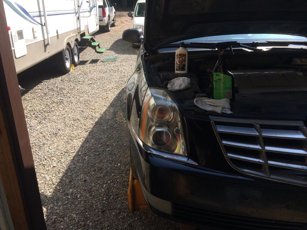

He tried it on his Jetta and claimed it works really well...so not to be outdone I gave it a try on Hoopty, the headlights were getting pretty cloudy..
Here are before and after, right side treated with the PlastX, left side not..
Not sure of longevity but might be as simple as an application every few weeks, nothing to it and takes just a minute...

I use this product on all my lenses on my Ram. It makes the taillights and the Cab Running lights just shine. I then put wax on them. They shine up very nicely. Also works on the Lexan windows in the race car.
Use a buffing pad on your buffer or electric drill when using Meguiars PlastX. It will then remove the dead/sun damaged plastic. Does great with a little mechanical help.
