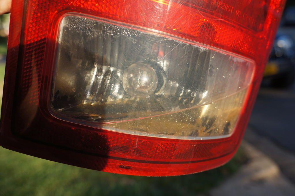

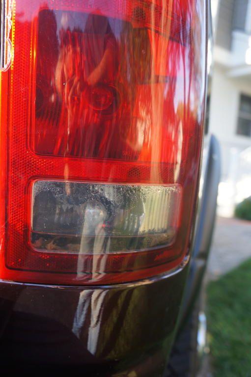

Then I noticed, in just the last few months, that there was water in the back-up lights. And algae. All I needed was a goldfish. Both sides!

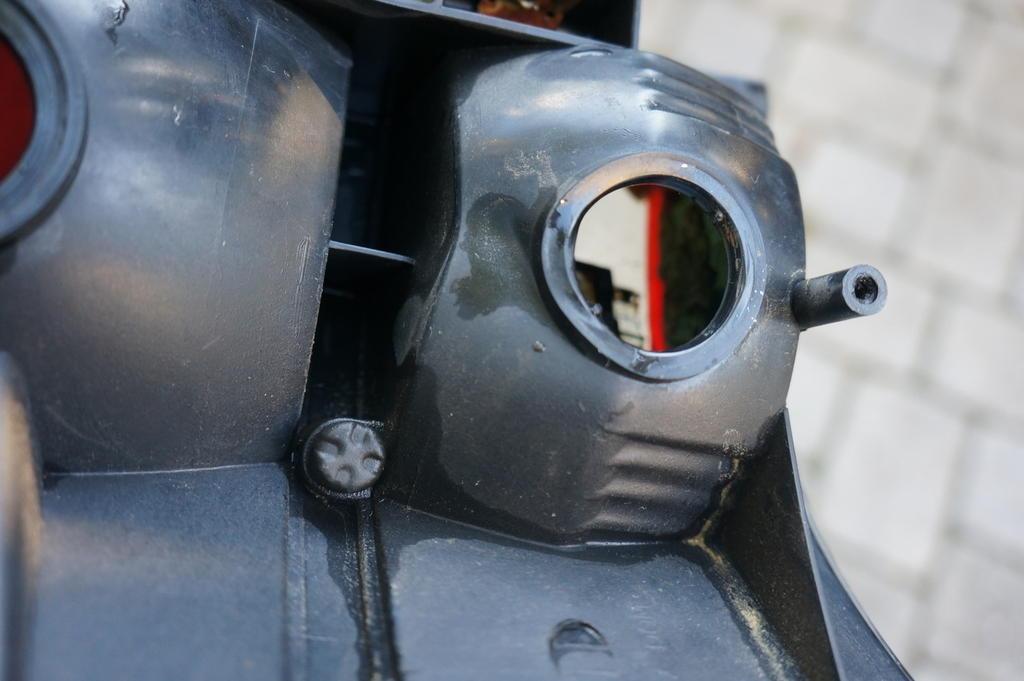

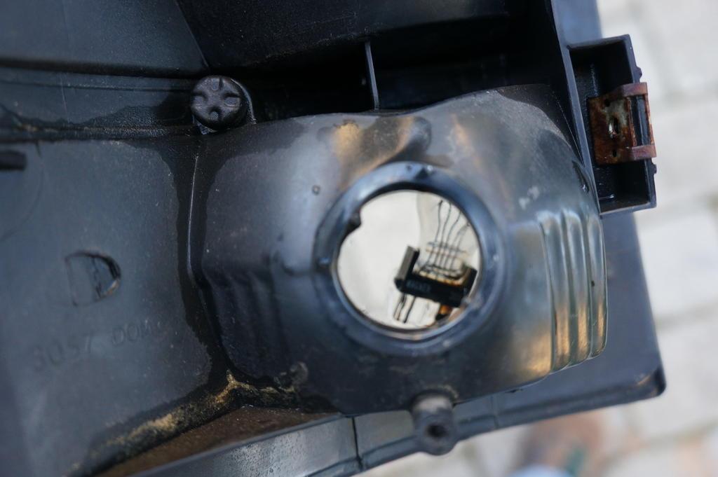

So I took them out to look. The holes for the back-up lights were totally melted. The right side was so deformed I could not even get the bulb out of the opening anymore.
The sealing surface was pulled away from the rubber seal by about ⅜ of an inch.
What I don't get is, according to the mold, the tail lamps were made in July 2003. They've been on the truck for close to fourteen years. But, it's only the last little bit where the back-up lights melted the housings.
I don't get it.
Sometimes just before bulbs blow they generate more heat.. but both sides is unusual... maybe the reverse lights have been staying on as a result of a bad switch or aomething?!!!
Possibly wrong bulbs. Manual says 3057, actual bulb was 3157. Same 3157 bulbs in the other holes as well, which also call for 3057s. Some catalogs say those two part numbers are interchangeable...
I replaced the lamp housings and circuit boards. The one circuit board was cracked, the other was not giving me a good connection to the back up bulb any more, showing a lot of rust. Anyway, I am now using LEDs for the back up lights, hoping it won't happen again. At least not for another 14 years.
