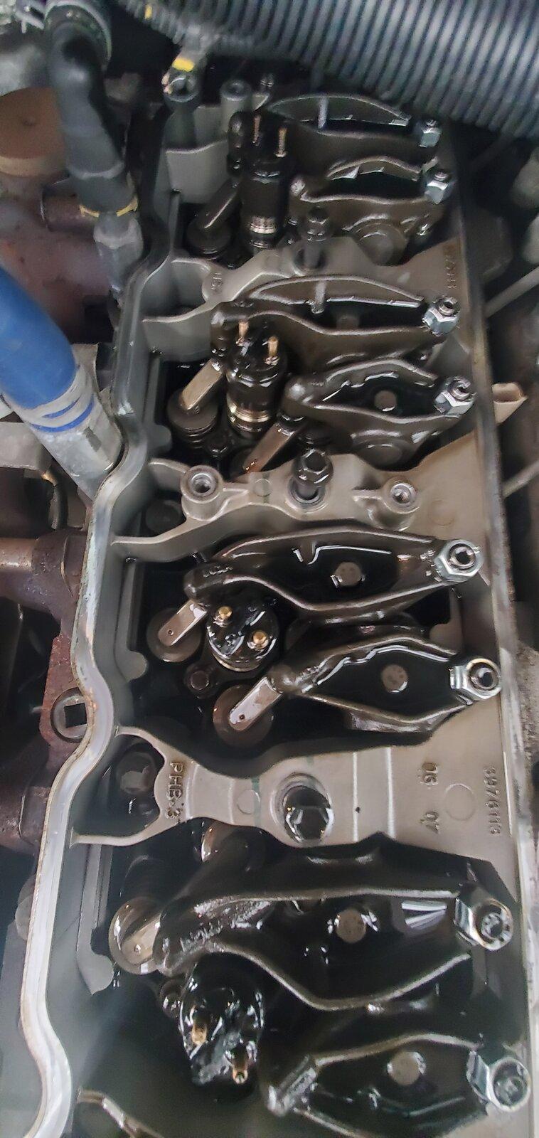

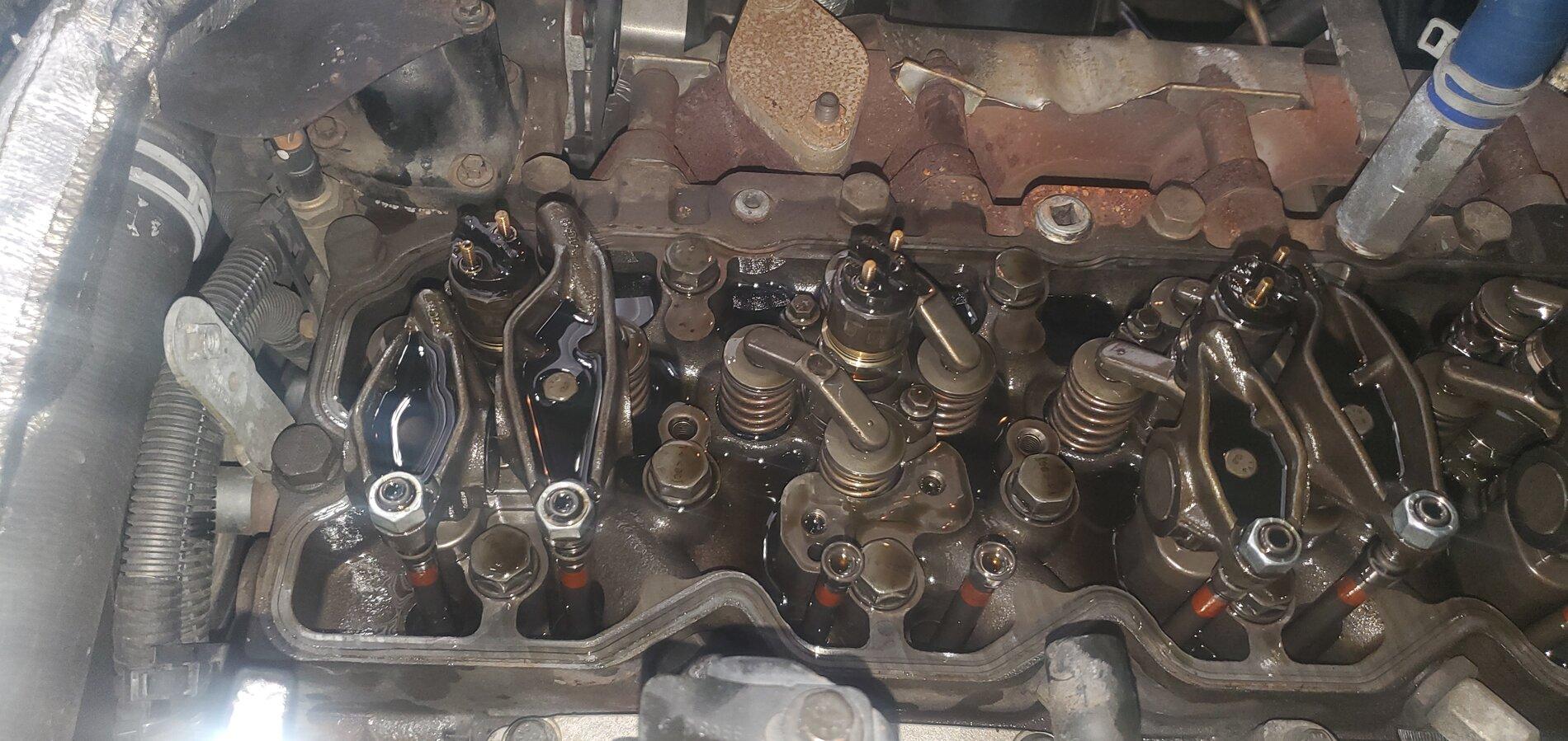

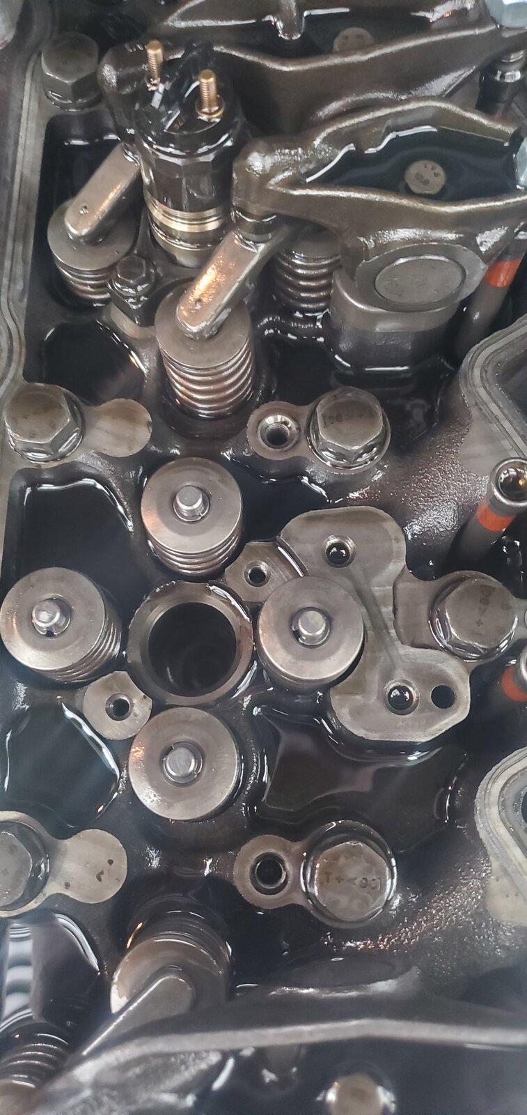

Back several weeks ago when I shut down my engine I heard quite a bit of water girgle in the radiator. Replaced thermostat and radiator cap. About a week ago the engine started running rough and engine up to about 220 degrees. I took the truck to my local RAM dealer Monday. They first did a compression test. Cyl #2 ran about 200compression and #3 was a bit over 300#s. They did find a bent pushrod on #2. They are beginning to think I have a bit of blown head gasket. Any suggestions?

With a bent pushrod I would suspect debris in the cylinder and a bent valve leaking compression. Can they drop a borescope down #2 injector hole? Although sounds like the head needs to come off anyway.

No debris in cylinder. Had a diesel business test the injector today and it checks out. I ordered just not a gasket kit, head studs kit and crankcase filter. Dealer will pull head Friday.

Removed manifolds, valve cover, removed head and shaved. Removed all valve parts and cleaned. New valve stem seals. Replaced one bent push rod. Serviced valve seats, all gizmos related to valving ground and reseated. Cleaned and serviced engine service for head reinstallation. New thermostat. New anti-freeze and engine oil and filter. Cleaned surfaces on manifolds and installation. New CCV. All gaskets new. Installed new head ARP studs. Everything reinstalled and no parts or bolts left over. Total cost at dealer. $3,923.00. I supplied all gaskets, CCV, seals and ARP stud kit.
