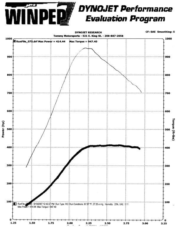

Have not dyno's with the PRD35 and throttle cable fixed, but is most likely 325 and 650-700 area! Power was down quite a bit because of throttle cable when I dyno'd! If the cruise control gives me very noticeable more power than the go pedal then the dyno should see quite a difference.

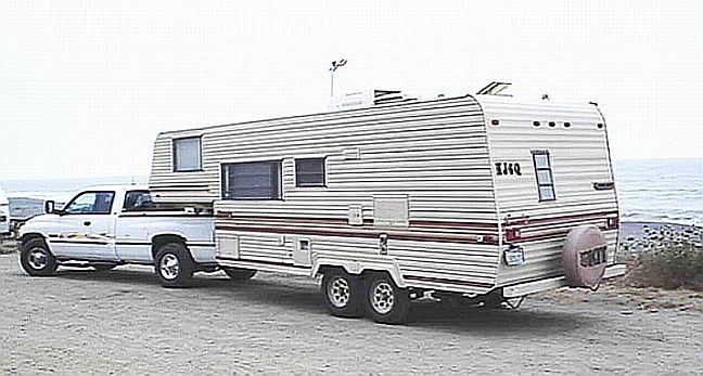

My GCVW when towing loaded runs about 16,000, We regularly tow long, steep grades up at the 5000 foot level, 5th gear, at 55 mph - and I built the truck this way SPECIFICALLY so I would NOT be a slave to the gauges - and so far, it's working - believe it or not! :D
As to Dyno - Imageshack seems to have lost my last dyno run pic, but here's the one from the year before, only slightly lower - I'll have to dig out my originals and rescan them for Imageshack...

Yes and I run the Syskiyou's in 3rd at 55 mph regulating the speed with my right foot without EGT issues. If I wanted to go faster then I would have EGT issues, which I dare say that you would also! Not calling you a liar, just trying to level the applies to applies issue. You are running a bit light and low profile compared to many towing with 2nd gens. SNOKING
