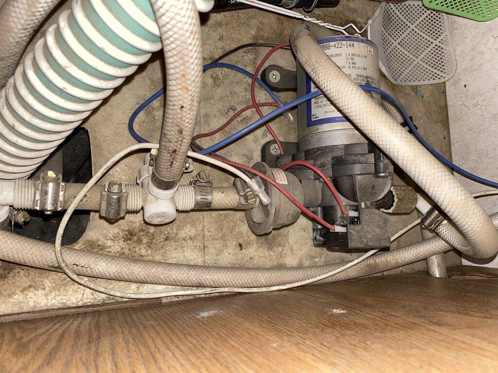

So, because warranty, the results of the rematch are in. The replacement pump is still working after a long stay of 45 days in the RV.
The turn on pressure could be higher as the waterflow nearly stops when the flow rate is so low the pump starts cycling. The variable speed pump is able to avoid the constant pump cycling the on/off pumps do, but, I have to use a high enough flow rate. It's a bit of an adjustment every time I want the pump to constantly run. It started cycling when I was using the shower one time NBD other than I worried for a second the tank was empty as it was low when I started the shower.
I see the issue with the whole made in the USA thing as I have several friends in the lighting industry who have factories in china that produce most of the components and assembly plants in the USA the put it all together and they are allowed the made in USA label due to this process. I would suspect that is what Remco does also. As for pumps I have put several Remco pumps on different trailers and the only failure I have had was on my personal trail due to it running dry for probably a week. The pump would still work but wouldn't pick up the water if the tank was half full nor would it hold the pressure in the lines. This is my pump of choice make sure you have enough amps to run it though.

I have the small quart size accumulator in my trailer and the water pressure is very steady. I can flush the toilet without the pump running in the middle of the night which is a good thing.
I’ve had various size accumulators in my trailers and have come to realize that the bigger the better. I currently have a 5 gallon accumulator and wouldn’t want anything smaller. It just works better.
Been following this thread, a few months ago we were out in the 5er and came back to find water peeing from the fresh tank vent, we were hooked up to the city supply so the only thing I can think of is somehow the water passed through the pump back to the tank and filled the darn thing up. We disconnected and ran the pump the remainder of the weekend to drain (use ) the tank because I rarely travel with more than about 1/3 tank. Is this indicative of a failing pump? Its a Forrest River Sandpiper and 10y old, been rock solid so far.... Air conditioner on the other hand are garbage as we're on our third Dometic 15k.
You need to think of a setup with accumulator is similar to a well setup. The larger the tank, the longer the draw will be before the system needs to be pressurized. The only limiting factor is space on where to place it! Location in most is very close to the bedroom as that where most of the water sources are located, so the noise is a factor at night.
I think the quality of pump makes a difference. Don't know what mine is but it does not pulse it simply comes on as needed and is NOT loud and annoying. IMHO there are many other noises in the night that would get my attention. I always run my exhaust fan in the open or closed position in the bedroom for white noise.

I have an accumulator in my trailer. Besides allowing me to briefly turn on a faucet or flush a toilet at night without the pump running it serves as a cushion for the plumbing when hooked up to water supply in a campground. I work for a water company there are times when there are surges in a water supply. Someone could slam a fire hydrant shut, a pressure regulator or large pump could malfunction. All this can put extra strain on the pipes.
Yes there is a valve (or 3+) in the pump that is leaking back into the tank.

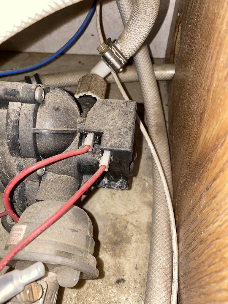

After a week of use caused this:

RV parks... Worn out 30A plug. RV park claimed everything was fine as did the RV service tech. Even though the plug was hotter than it should have been to the touch.
