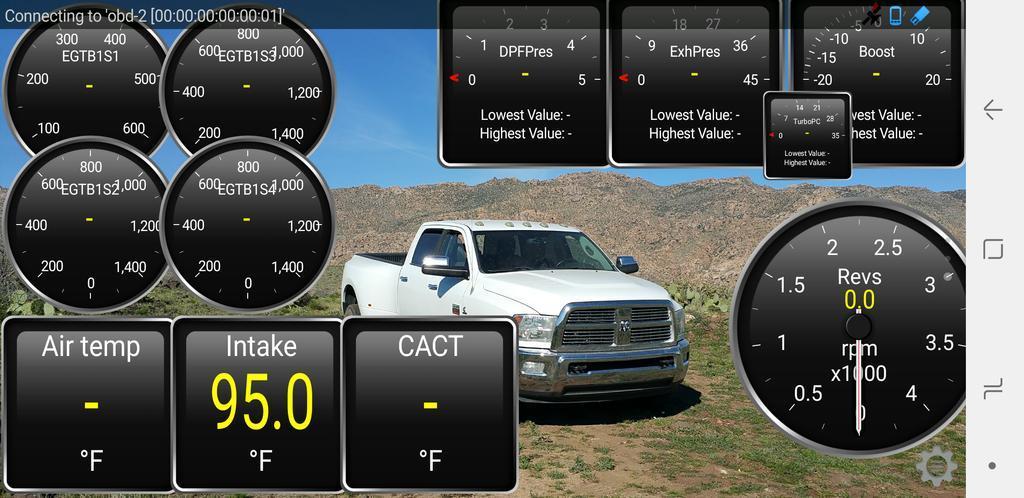

I have Torque Pro and Torque Scan (free with pro, but separate download). Installed it on my old Tab A 7" and looks great with a custom background :)

That screen cap was from my S8+. I also have a Samsung Tab A 8" with the app and a magnet mount for in my Jeep (just another profile in the app) that works awesome. The tablet is only wifi, but has GPS. I just download the maps I want (wheeling and gold prospecting) for my Topo Maps Pro app at home and go.

OK,, was gifted a Tab 2 7" and got Torque Pro downloaded and started setting up gauges. When I selected the EGTB1S1 - S4, they all show in *C. I'm like WTF?? I have all standard setting in Torque app set up for MPH, PSI, *F, etc but don't get why the gauges show *C... Any thoughts? What did I miss? Thanks in advance.
From the main startup screen, hit the setup menu button in the lower corner. Select settings. Select units. Uncheck the Celsius box

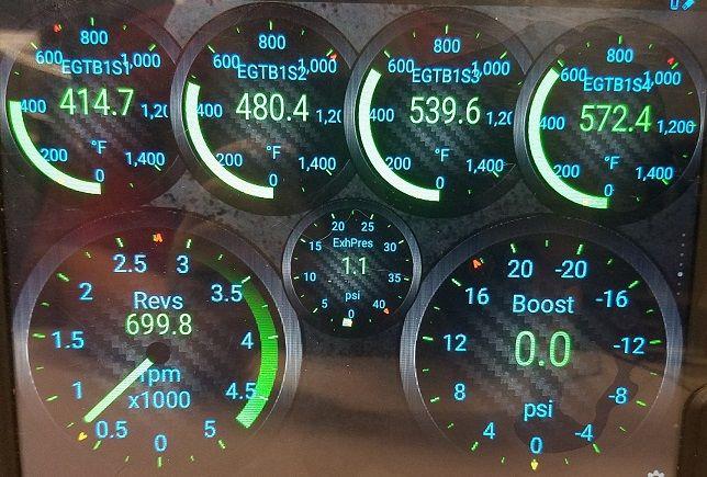

OK,, got to hook it up and run it the other day. Once connected the gauges that were showing *C are now showing *F and appear to be correct. I set up all 4 EGT gauges for the heck of it. I was going to shoot a screen shot but the Mrs said it was dinner time. Can't keep her waiting. (LOL) I'll snap a pick of the screen next time I get a chance.. I think I've got a calibration issue on the DPF and one other one but otherwise everything looks good. Many thanks!
