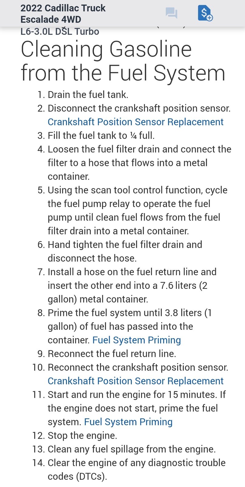

From some further research, the Chevy dealer was spot on! Guess they found they can really beat these things up.
As of Nov 29th 2022 they added a Diagnostic Tip for Fuel System Contamination that made the following correction in place of fuel system replacement.
This is listed under the 2023, but the actual procedure is not uploaded yet for 2023, I found it in 2022.
If you encounter such a situation, DO NOT replace the fuel system as described in Service Bulletin #16-NA-102.
Please perform the following fuel system flushing procedure prior to performing further diagnostics.
Once the fuel system has been flushed, continue with diagnostics as described in SI.
Here is the procedure for the Gasoline in Fuel.
