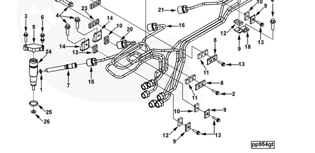

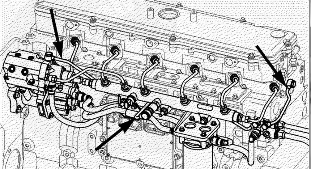

There are two seals on each injector and the fuel from each injector does return through a shared passage and exits at the rear of the cylinder head. So it could be one of the seal rings or even the head itself. Just head scratchin' thus far.
The seal rings are shown here.....#25 and #26
Now the ISC service book is for both CAPS Pump and Common Rail fuel systems so this drawing even though it is for a Common Rail shows the fuel drain (return) tube on the rear of the cylinder head as that is used with both styles of fuel system.
