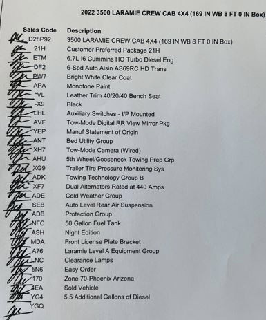

Fast forward to December and the options were better for ordering. I had been waiting on Towing Technology Group B and Laramie Level A (Level C didn’t have power folding mirrors). I couldn’t order two-tone like my 2018 but that just forced my hand on the Night edition, which I really like!
The truck is very similar to the 2018, both are Laramie Crew Cab 8’ bed HO’s with auto-level, 5th wheel prep, aux switches, cab lights, protection group, and cold weather group. New for the ‘22 is the Towing Tech Group B (360° camera), tow mod digital rearview mirror and extra camera, trailer TPMS, dual alternators rated at 440A, bed utility group, 50 gallon tank, and the Night Edition. The ’22 has the Laramie Level A package which is all things I had on the ’18 but the options were separate, plus a remote tailgate release.

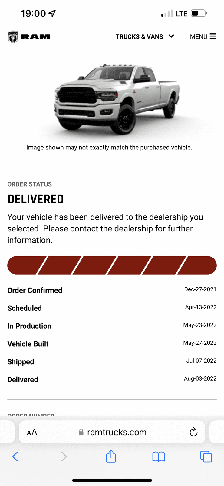

I placed the order on December 24th and was told to expect 12-16 weeks, it took 35 from down payment to getting the keys. The last couple weeks was on me as I was out of town for work.

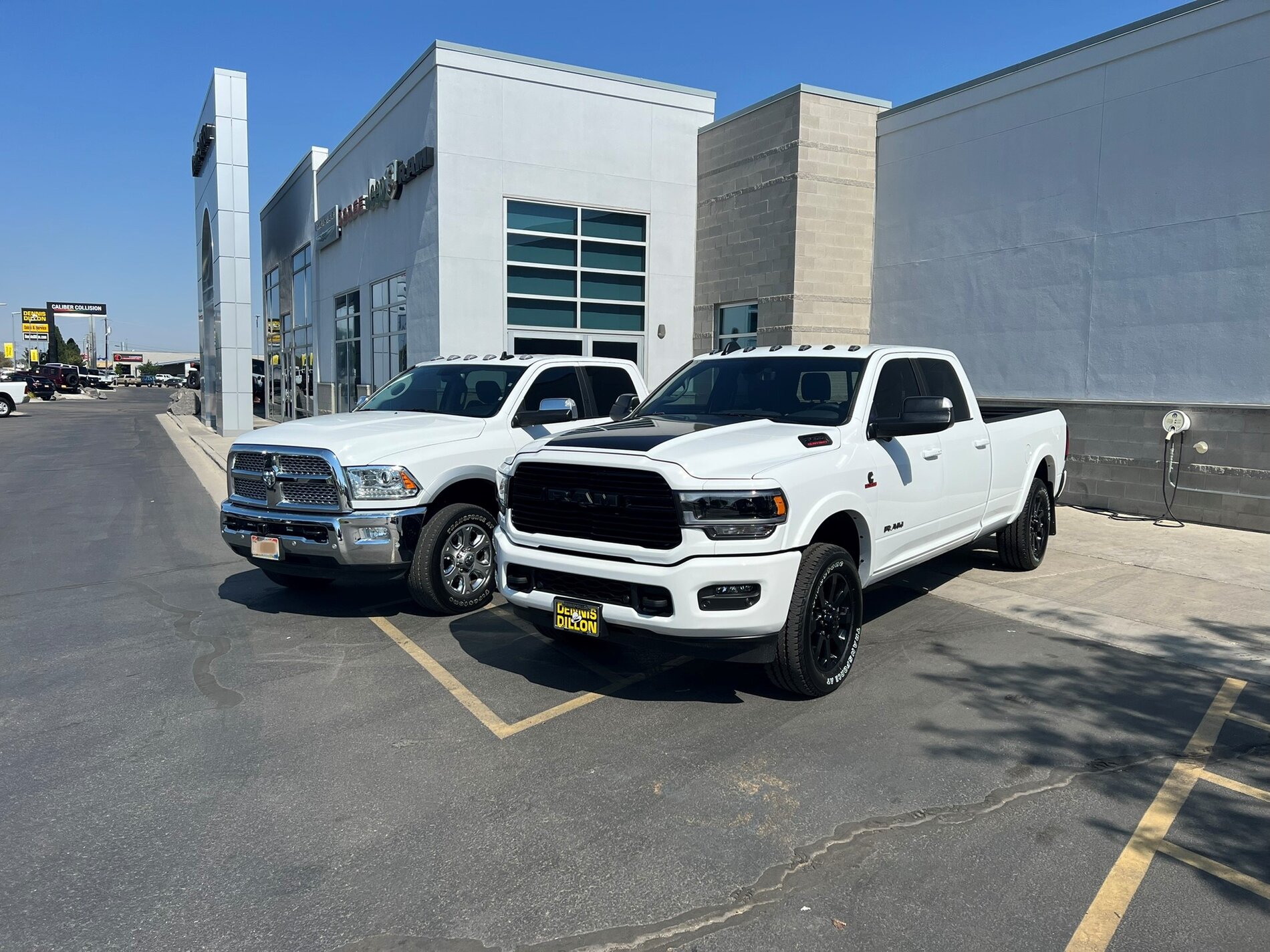

During those two weeks the dealership had time to install the tint, clear bra, and hood accent so it all worked out.

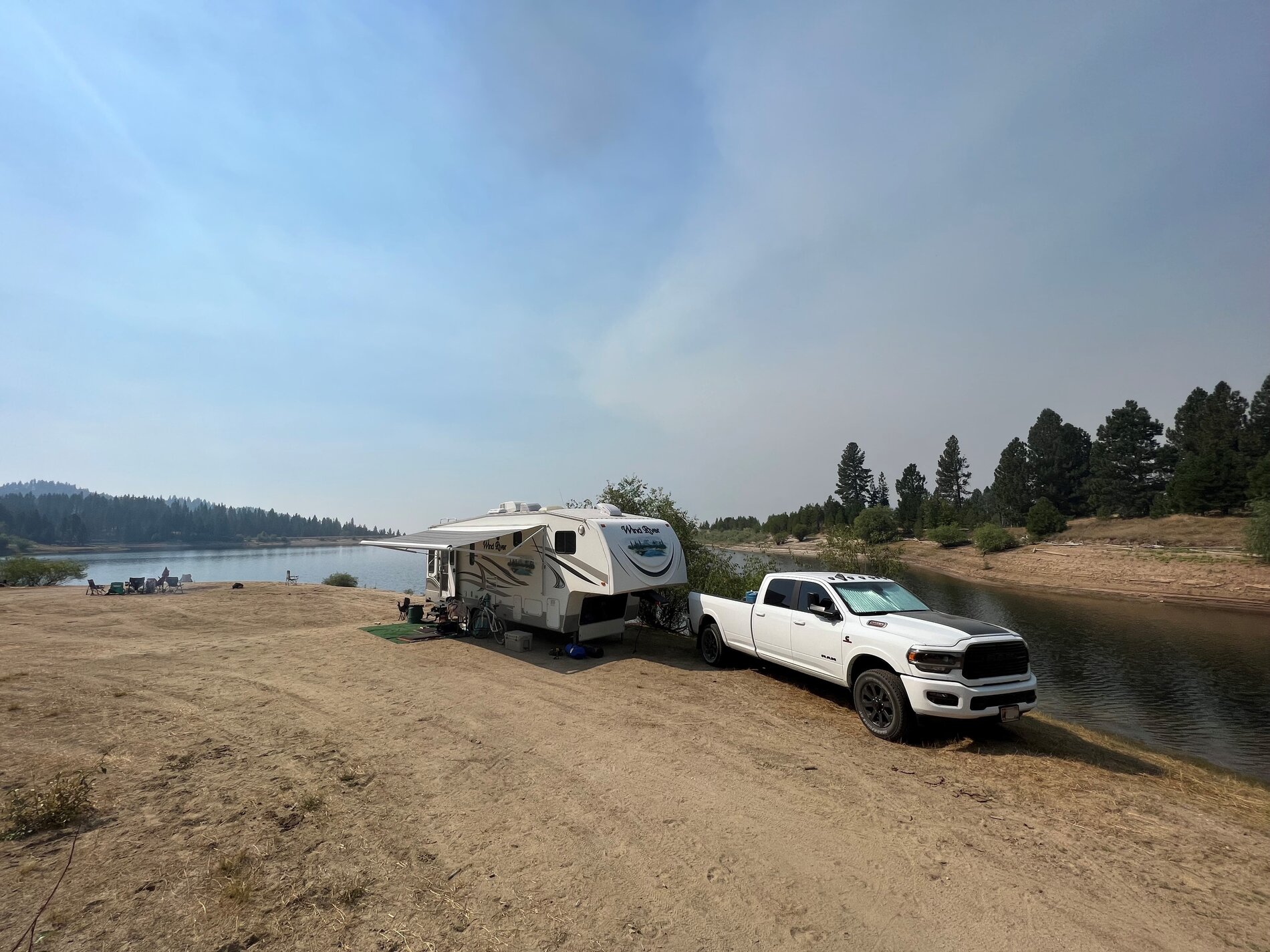

Overall I am very impressed with the truck and the differences from ’18 to ’22. I put the first 500 miles on the odometer in preparation for Labor Day weekend and hooked the 5th wheel up at 501.4 miles.
Peak torque to the wheels can be as much as 25% higher than the ‘18 due to the gearing changing to 3.73 and the additional 145 lb/ft of torque but I honestly didn’t expect to feel a big difference at low rpms and partial throttle but I can. Below 1500 rpms there is more power, no clue if it’s more related to the gearing or programming. The power is smooth throughout the rpm range. I don’t have my CTS3 installed yet so I am not sure if it’s gone WOT to hold speed on hills where the ’18 would but it didn’t feel like it last weekend.
I never had any of the Aisin programming issues on my ’18, but the ’22 is simply programmed better. Shifts are crisper and timed better, both in and out of TH on both up and downshifts. The transmission will now downshift going downhill in CC when the speed goes above the set point and the EB needs another lower gear. There is also a big change to the downshift schedule when not using TH but have a trailer hooked up which allows for much improved engine and exhaust braking.
