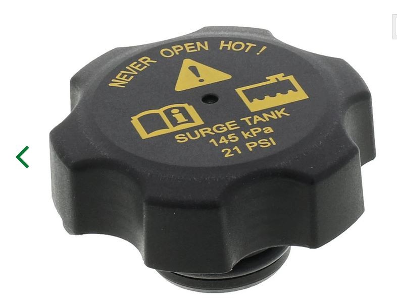

How did you suddenly arrive at, "Looks like it is a head gasket issue."? I believe the cap in the photo below is the one you have on your coolant recovery / surge tank. Relief valve is set for 21 psi. All cooling system components (including head and engine block) can handle this designed pressure. Are you losing coolant over this valve?
Fix the leaks that you know about and then pressure test the cooling system.
- John
