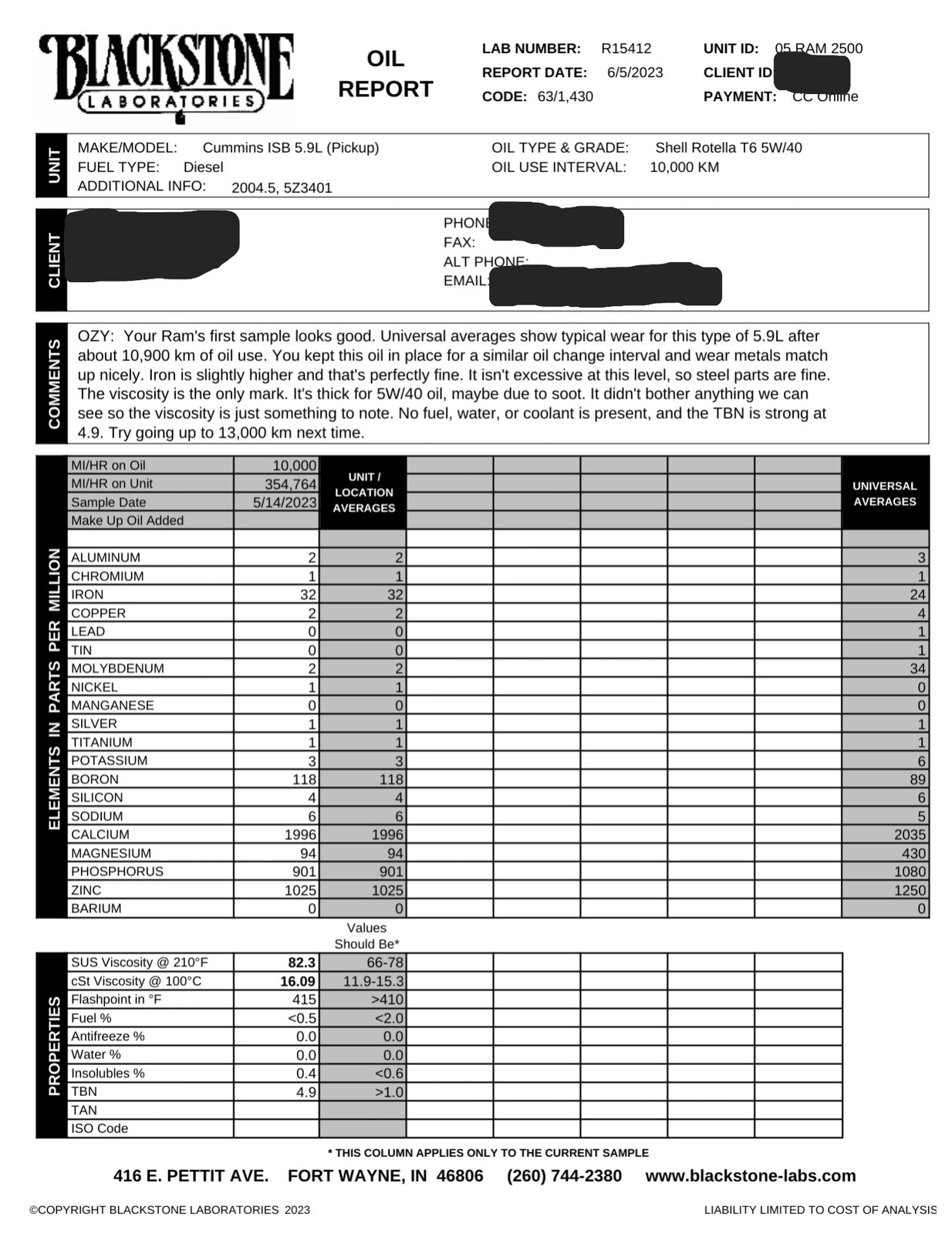

Just wondering what others think of this Cummins UOA for Rotella T-6 5w40 @4743 miles with DBL 7349 oil filter... I was not a happy camper when I read this in the comment: Viscosity is SIGNIFICANTLY LOW. I'm also surprised at the low base number of 4.05 being it stared at 10.6...
BTW this oil is from the dealership do to a big screw up last year... I am also surprised being I have heard of many others using this same oil in there 6.7 without problems or bad UOA reports

Looks like fuel is wreaking havoc on your oil. Have you noticed the oil level rising? 5% fuel dilution would equate to about 1/3” more volume on the dipstick.
Are you 100% positive they didn’t put 10w-30 in your engine?

The oil was in the engine just shy of one year... I have not noticed frequent regens, the last one I know about was some 600 miles ago while I still had the 800+ lbs of weight out of the bed...
I went to the dealer after I got the UOA report, talked to service manager, they swear they put 5w40 T-6 synthetic in it, my self I'm not sure they did ( or they got a back batch of bulk oil) based on the UOA and what Cummins had to say about viscosity...
It might be a good idea to go look up the specs of 10w30 to see its starting velocity & base number, this oil run I'm using Amsoil 5w40 ADO I bought last year and a LF16035 Strat as my Donaldson order was late and hope next UOA is better.
Oh yes I noticed oil growth on the dip stick ( was told its normal to see no newer 6.7 CTD o_O) that is how I accidently got the Rotella T6 installed last Nov as they were to get an oil sample for me ( but f'ed up and drained all the oil grrr) so I couls send it to Blackstone, that UOA showed 1.5% fuel in the oil with just @ 1396 miles on Amsoil 5w40 ADO, that is why I added 800+ lbs in the bed to help the engine to work a bit more, I don't have have a trailer to keep it hooked to at this time :(

I'm surprised to hear this being I ran Rotella T-6 5w40 synthetic in my old 06 5.9 without any problems for 12 years with Donaldson DBL 7349 oil filters until its last oil change in 2021, all the UOA's I ran on it up to late 2017 when I stopped doing them always came back good to go, I would put between 7500 an 10K on the oil over 12 to 14 months, fuel in the oil was never over <0.5 and this was during its time in north Iowa where it saw hot humid summers and cold subzero temps in the winter...

TBN being low isn’t a surprise on 12 month old oil as TBN starts to deteriorate as soon as you start the engine the first time, and will deteriorate even with low use and when the oil is sitting.
5% max is what Cummins recommends for fuel in the oil, same as Ram in the owners manual. I understand that the variable OCI is based on that approx fuel level, if it comes due before 15K miles.
The 6.7’s are more prone to fuel dilution based on how they actively regenerate.
B5 is not supposed to have any impact on oil life, but B6-B20 reduces the oil change interval to 6 months because of the potential for excessive fuel dilution. I personally doubt that there is a magic line at B5, so reducing your OCI may be prudent for B5.
I was more than a bit surprised at the TBN being 4.05 after 12 months, in my 06 5.9 even after 14 months of a humid summer & harsh north IA winter I never saw that low of a TBN number from 5w40 Rotella T-6... IIRC the lowest I recall for TBN was 5.X after 14 month/10K, that means I have to learn all over again with this new fangled 6.7.

Modern oil specs, CJ-CK, start with a lower TBN because it’s not needed with ULSD. I never tested CK in my 05, bit the CI I ran would be in the 7-9 range after 12 months of use.
I haven’t tested my 6.7’s but I expect a much lower TBN after a year based on how the oils are designed.
