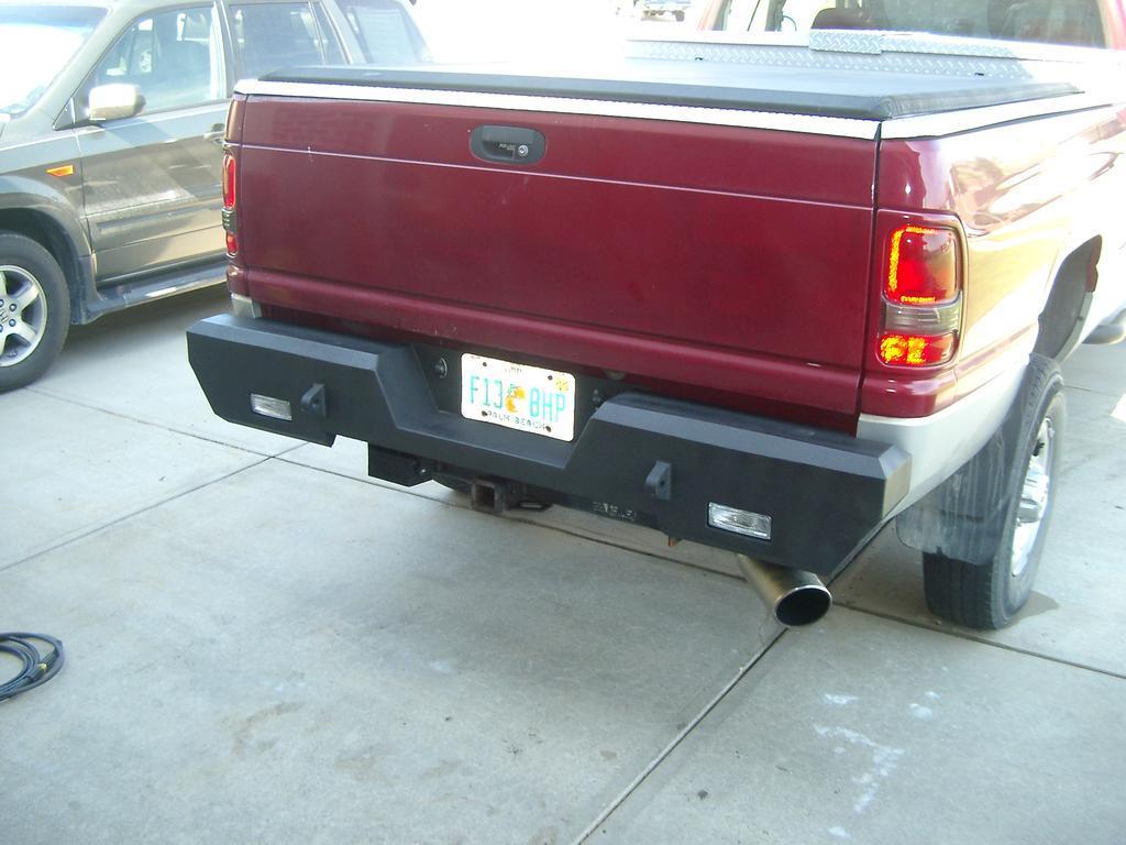

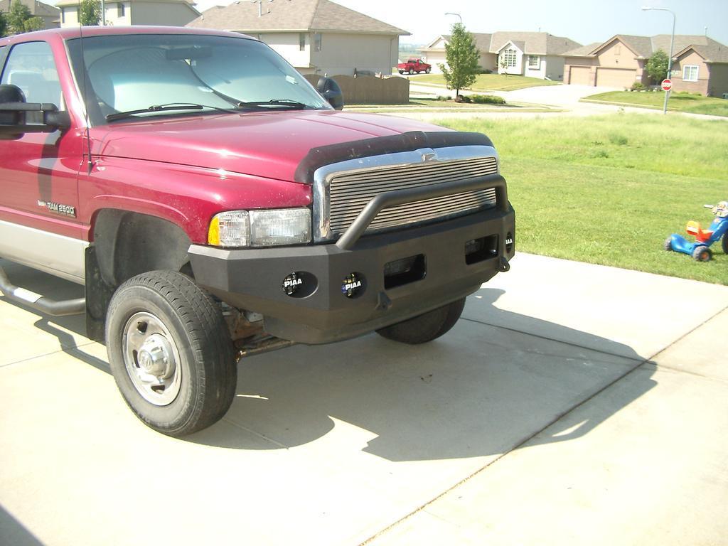

My $660 Bumpers!!
Tri fold bed cover for 8' bed
Toyo C/T?
4x10 sheet of 3/16 plate - $323 (of which I have about a third of it left over)
Random pieces of angle, strap, weldable angles, and recovery eyes - $200
2 10lb spools of welding wire - $90
8 Rattle cans of spray on bed liner - $48
Not having to shell out $3500 or more for aftermarket bumpers - Priceless:-laf

Thanks. I started last November thinking I could have both done in 3 months. The rear I knocked out in a month and was making good progress on the front until my garage just got to cold to work in. Then this spring it seemed one thing after another took my time away. But they are finally done... Aside from a little wiring for the lights.
If you built those bumpers you should start a bumper business, that some great work.
I'll second that thought.
I just made a bumper for my beater Toyota farm truck. The bumper I made matches the truck. (Well, it's not all that bad, but it doesn't look like yours, Mark. )
If it took you months to make those bumpers, I'm sure you understand why they charge $3500 for the store-bought ones. Most of us can't do work like yours even if we did have the tools and the time.
Great bumpers.
-- Loren
Very good looking job. You have talent. Hear what the guy are saying... .
I built one for my old first gen and it didn't look very good, in comparison to yours. GregH can verify... I even work with metal for a living. You have a good eye for it.
