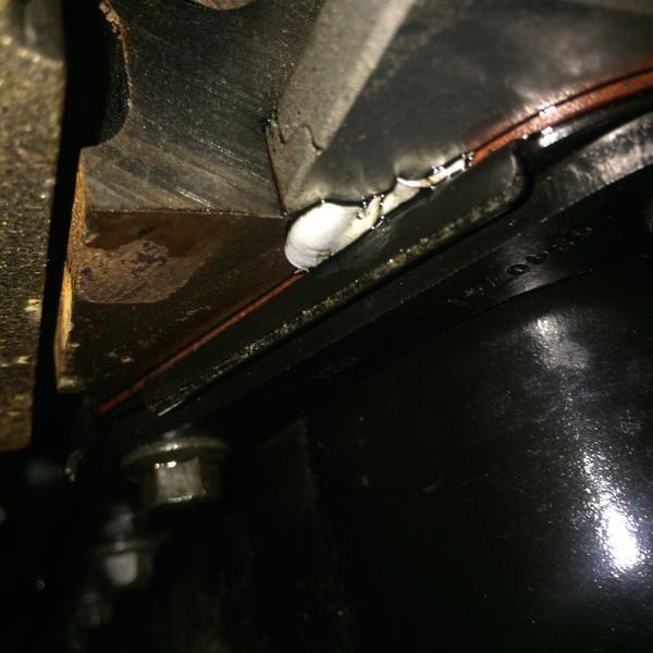

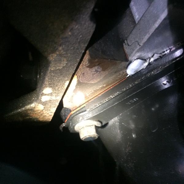

Well I'm going to have to take my truck back again for the same issue. My oil leak is still with us. Ram replaced the front crankshaft seal at 4,450 miles. I'm now at 5,050 miles and this is what I'm seeing. I cleaned and inspected the area after the seal replacement so this is new leakage. I'm convinced that it is from the RTV joint at gear case/oil pan/block joint as there is no oil present above pan on the block. I think I'll ask then to lower the oil pan, clean up the block and reapply RTV to the joint. We'll see if that fixes it. If they want to pull the gear case, I'm not going to allow it. I'll just wipe off the oil every oil change for a while. Do you know what has to be removed on front of the truck to pull the gear case if that is the source???? :( :{ Oh no you don't Mr. service technician. I'll have to think about that long and hard. It doesn't leak that bad! #@$%!
I'm with you. It is a fairly major job to remove the gear case, so be careful what you wish for. Getting the pan off isn't a piece of cake either.
Sag2, can I just drop the pan down, clean the gasket surface on the block, remove all the old RTV at the joint, then cut a new the gasket into two pieces, reinstall the gasket, leaving the gear case where it is, the way it is; then put some RTV at the two gear case to pan joints? I'd use a small amount of RTV at the cut in the gasket just to be sure. Do you think this is doable? I really don't want to pull the entire front end of the truck part, but I don't want my truck to leak for the next 300K miles either. It is a manufactures defect after all. What do you think? Ken Irwin
Cutting the gasket in half sounds like a really really really bad idea. I recommend leaving it up the boys at the dealership and see how it goes.
If it's under warranty let the dealer do it. If your not happy with the dealer you,ve been using just ask on here who you should go to in your local.
