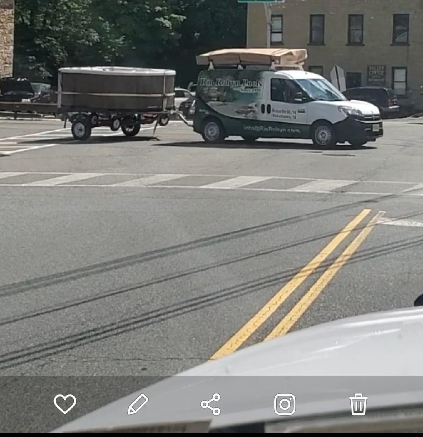

I think this guy was at the same Uhaul and he made out OK.

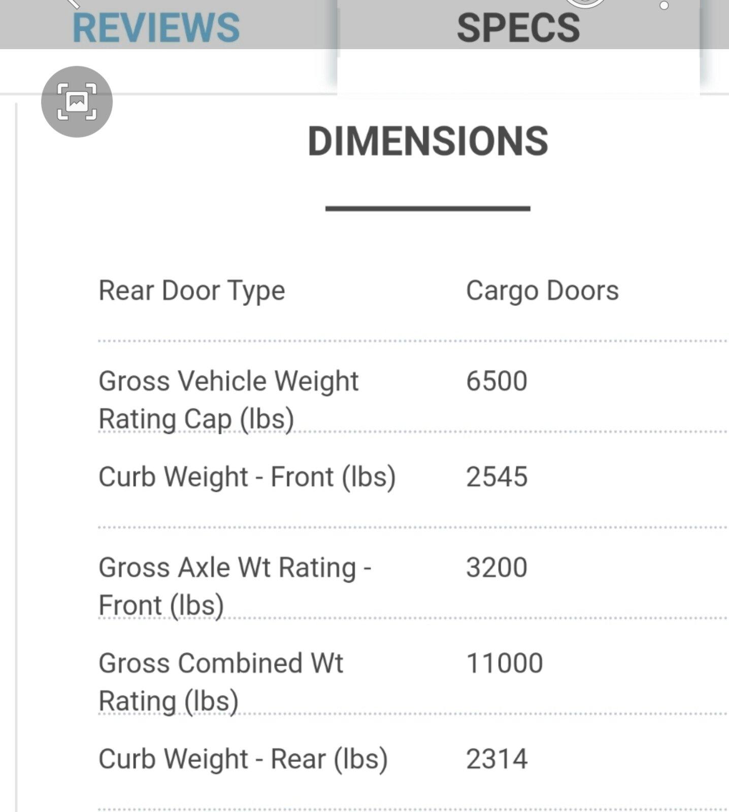

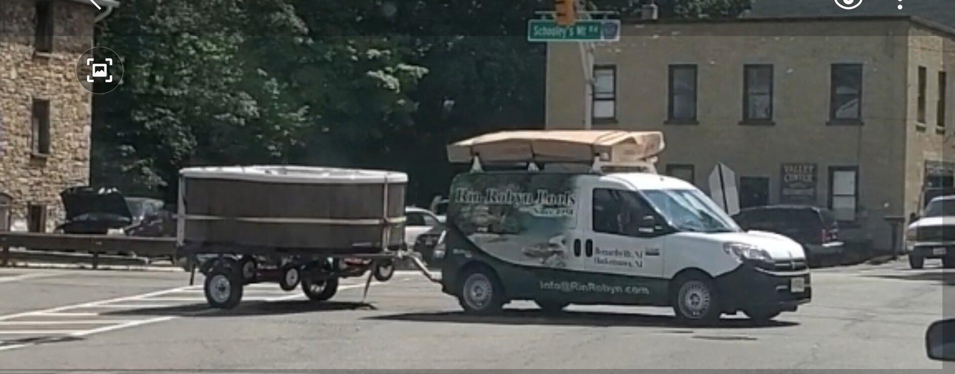

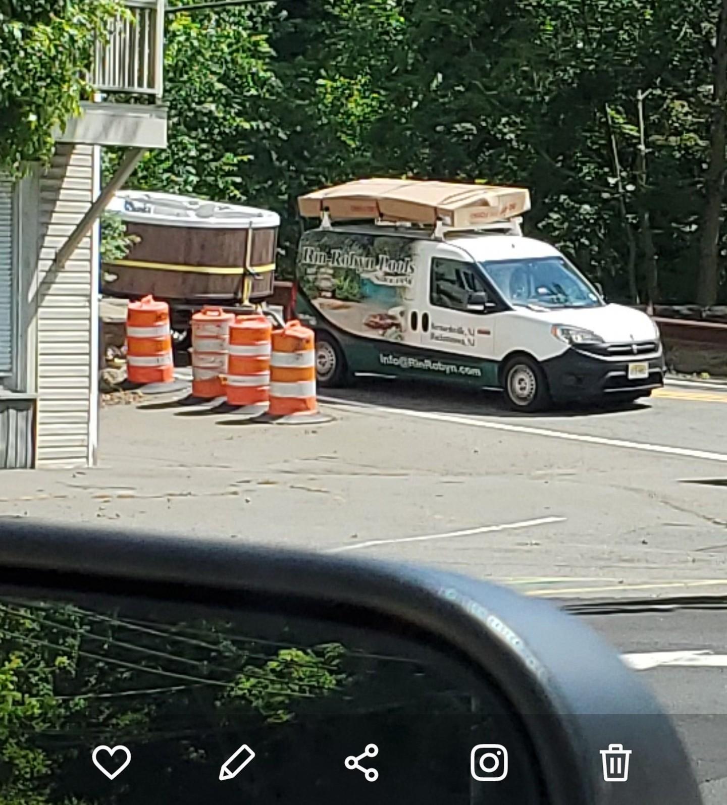

Saw this today, I'm sure weight wise it was fine, but yeah little undersized and has an odd tounge to the trailer.
Especially that road this thing just came down has a decent hill for NJ.
I have 2 of those promaster city. Drum rear brakes and all, can't knock umm for getting it done.

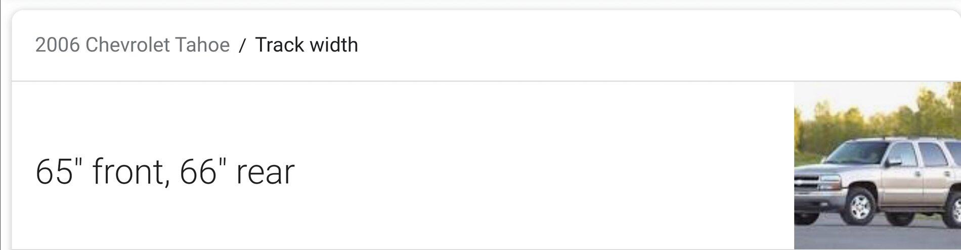

U-Haul may have denied renting the trailer due to the track (width) of Tahoe. It might be too wide to fit on the U-Haul. I looked into renting a U-Haul to transport a Suburban using the truck in my signature and the trailer was too narrow. The U-Haul computer rejected the use at the time. And it was correct. Have hauled other autos with U-hauls and no issue. I would contact a different U-Haul location too. "Talent" varies from location to location!;)

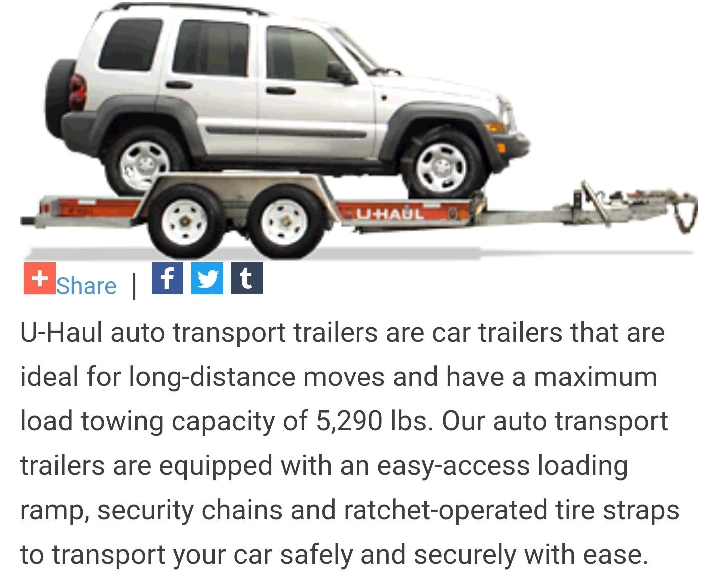

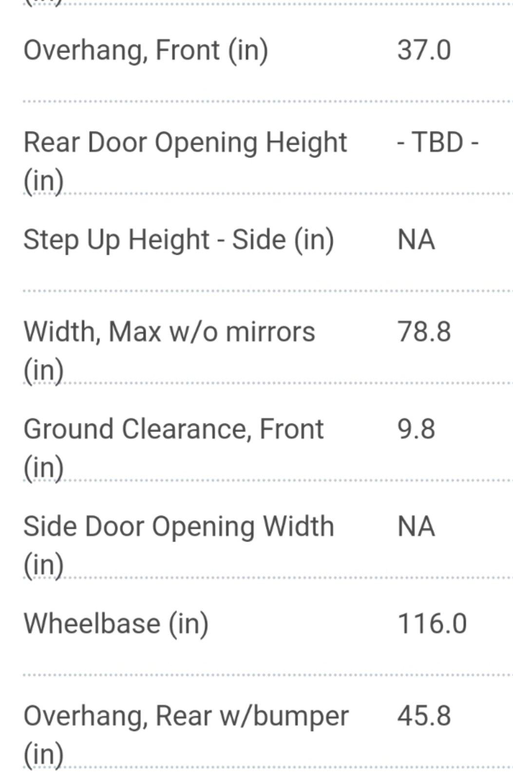

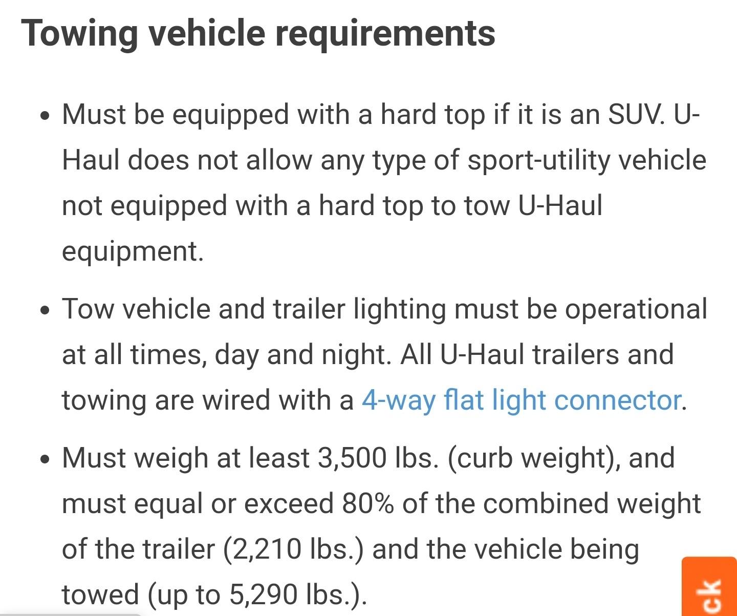

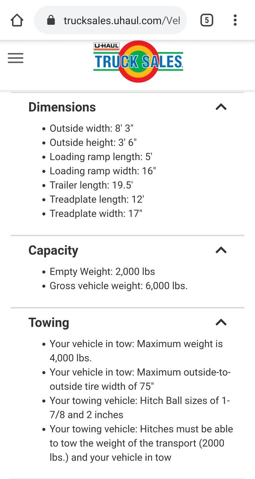

Should be fine once they see your set up, I would measure the Tahoe, it looks like it should work, the one thing I see is the max width 78 and change, and the inbetween trailer is about 77, just depends on how tall the fenders are and where that 78 is measured.
Here is what I could find. Weight of Tahoe dry 4859 call it 5k unless your fully loaded it up.
From the UHAUL sales site says 75"-77"ish between fenders.
That my friend is a lot useful information..
Thank you for the effort! Gary
No problem. I think it would be fine. I had an '07 and '10 tahoe, and now a '19 burb, they sit pretty high up.

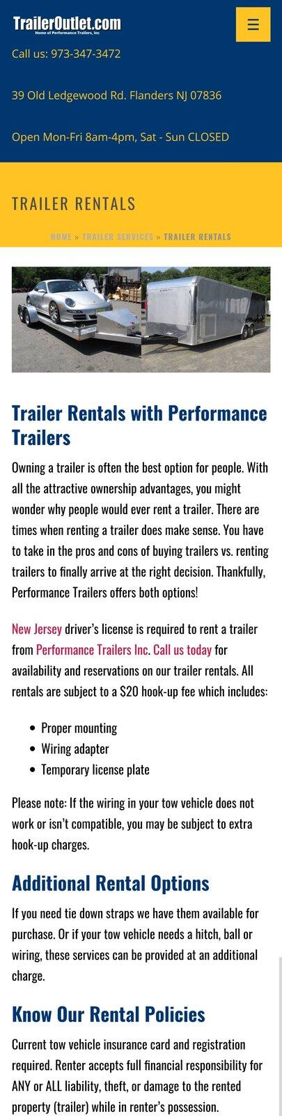

Just in case and if your not going one way, my local trailer place that sells trailers also rents units out, just need your insurance and deposit and the sort.
Maybe you have a place close by as an alternate.
