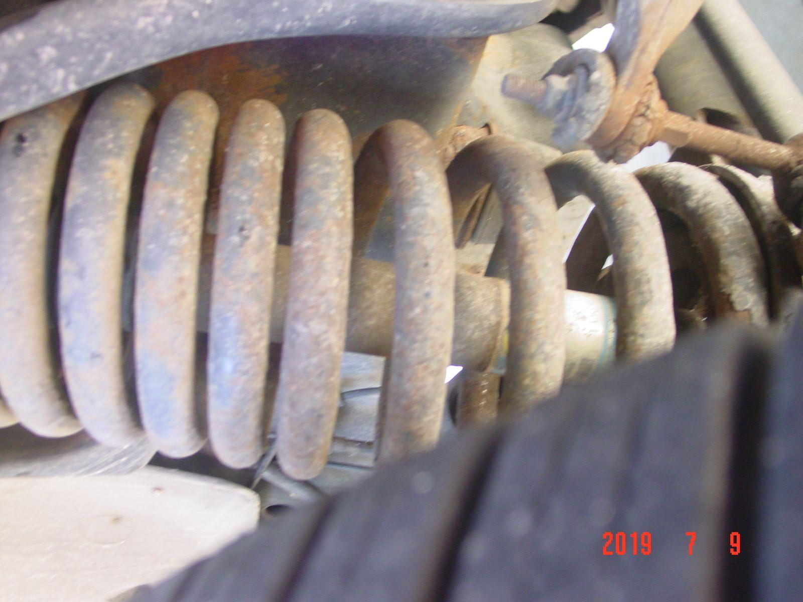

I tried helping the front in 2010: KORE HP Leveling Kit (frt) 1998-2010 Diesel, P/N 1A-6010-00 & Variable rate front coil springs & Bilstein #51860-63856 F4-BE5-6681-H8 Gas Pressure Monotube shocks. $399 kit, $105 ship, $486 labor. Swapping out the coil springs was a major time/labor i$$ue.
The variable rate is nearly collapsed by now.
I'm getting nowhere fast with: Eibach, Carli, Koni or Bilstein, Monroe reps yet. Basically looking for adjustable compression shocks to experiment with. Don't know how I had time to get anything done prior to retirement! Somehow we did; working OT, raising 4 boys, fixing cars & helping neighbors. Sometimes I agree "...youth is being wasted on the young..." Hmmm, looks like a small proj this week for the grandson, replacing those sway bar bushings. :rolleyes:
That is the problem with variable rate springs is they go to coil bind at some point in compression. I would replace them with the Thuren Soft ride springs and a Carli mini-pack for the rear. Air ride eats would be another great addition for ride quality. ;)
