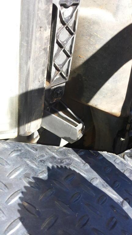

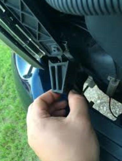

I've searched and cannot find this part. It braces the bottom corners of the grill when the hood is closed.

If so I'm thinking that's part of the headlight assembly??? I'll be home in a couple of hours and I'll look at my '06....

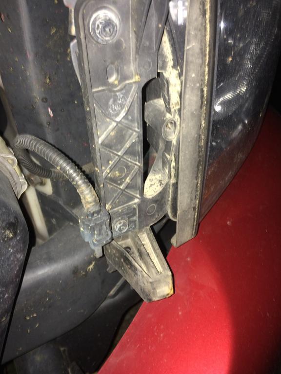

Yes, it clips into the framework at the bottom corner of where the grill closes against the truck. I guess it's supposed to brace the bottom of the grill.
It's not a separate item from what I see. Did it get stepped on and then it broke off???
I have the truck down here today, I'll look again but I'm 99% sure it is part of the headlight assembly. It was dark when I looked last night,,,,,
Gene, I just knelt down, wiggled the little plastic bugger and looked again. It is not part of the plastic headlight framework. It appears to snap into the metal behind.
Let me see if I can snag a part number.......
Sorry Gene, I missed it last light, shoulda' taken a brighter light out with me...

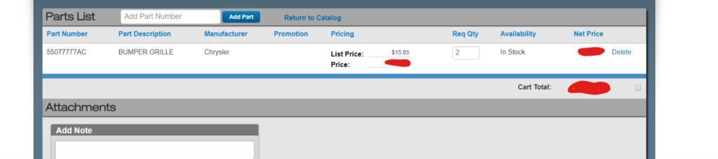

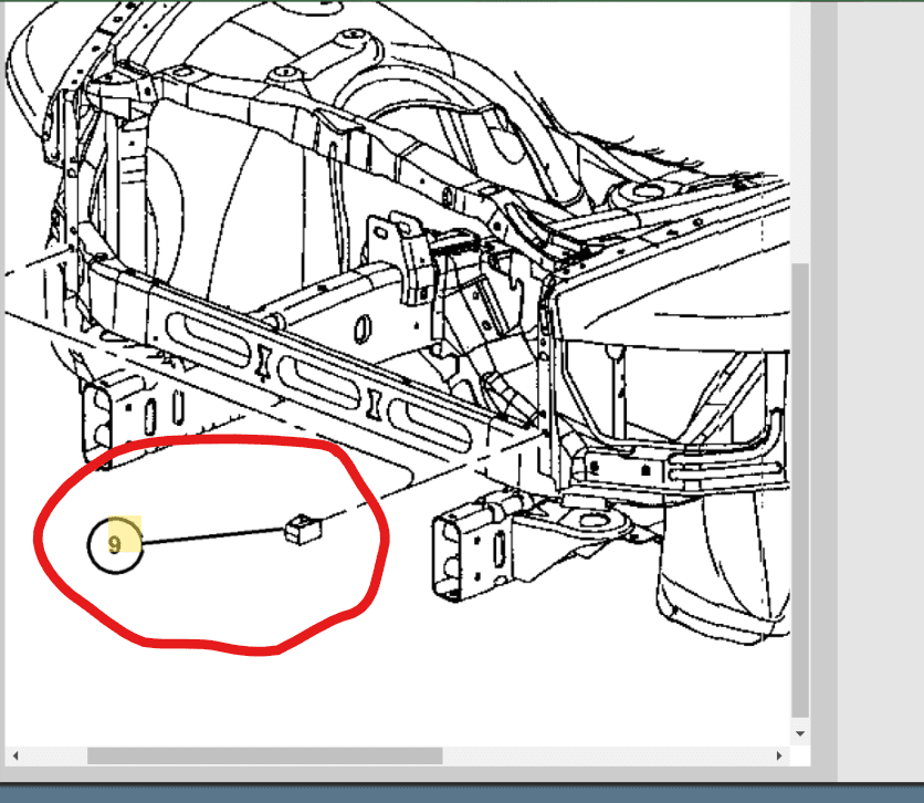

I believe you want one of these...55077777AC

Mike, I couldn't find a good Dodge website with decent parts diagrams that you could blow up where my old man eyes could actually see. Is that site you're using something you need a login for?
