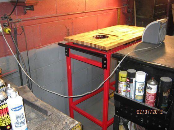

The new one

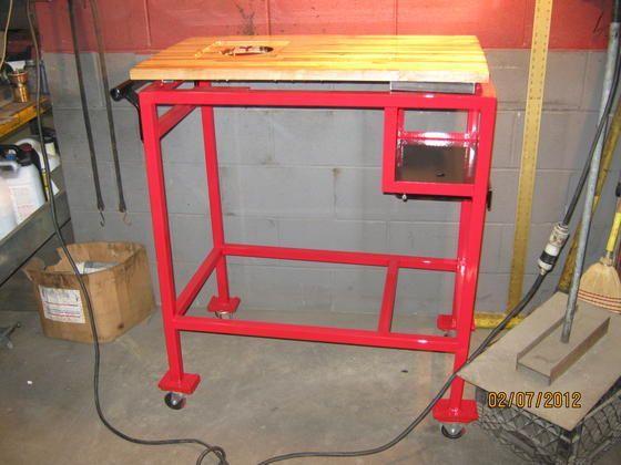

This is the new tester that we are building as we get time.
This will be called "The Espar Dyno!"...
Paint shop was spraying a gloss red truck the other day so we kicked this in there with Billy, he did a great job squirting it.....

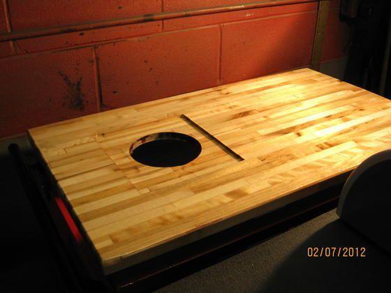

This is the bench, two pieces of trailer flooring with a coat of floor restore on it. It will take all week for it to dry. A lot of techs make tops for their big rollaway tool boxes out of the trailer flooring.
