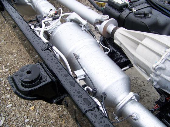

Well here is the twisted story about that...
It is in reality a Cummins DPF unit that is used on Freightliner, Sterling and Western Star Cummins powered trucks. So it is a Cummins part installed to the truck builders preference. Makes it a little interesting when you are trying to track down a sensor... ... ... finger pointing ensues as to who put it on.
In spite of my whining I believe that size was the factor in using the one piece unit on the RAM trucks, but I feel it could still be engineered with removable ends to facilitate cartridge replacement or cleaning.
I don't have a picture of the Freightliner one handy, I'll see if I can locate one tomorrow.
Mike.

Here is a pic of a DOC/DPF and an SCR catalyst on a FTL M2 with an ISB. They are a bit bigger than the dodge unit

Thanks for the M2 picture, I have been stuck working from home and don't have my normal access to a lot full of trucks. That looks huge but the RAM system is almost that big. They have a package that fits where the right hand fuel tank is, the DPF and SCR are stacked one on top of the other.
This DPF on the 2013 RAM is big enough to accept the clamp and cartridge system in my opinion.....
Mike.
