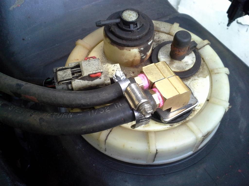

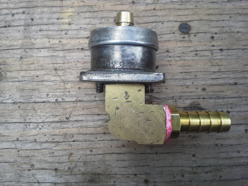

Since I had no money for that I went this way : (cost me time and some fittings...)
