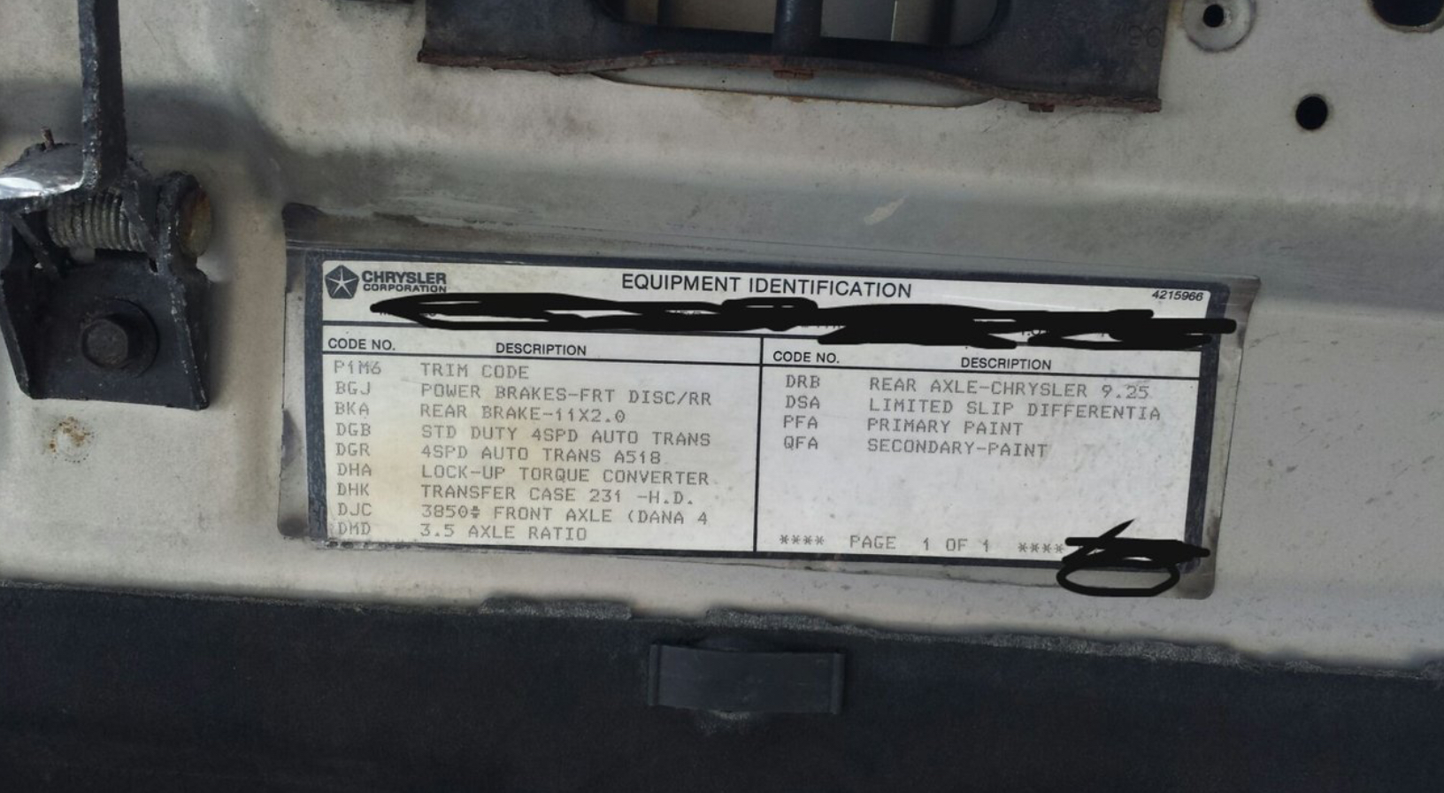

So it looks like the deal is going to go through. Next week I should be picking up the cleanest 2nd gen I've seen in a long time. It's a 2002 quad cab short bed 4x4 with all the options. What I'm trying to figure out is the engine. Is it a so or ho? The vin is a 6 but it has the 6 spd. I keep reading that all ho engines have the 6 spd. My question is, do all 6 spd have the ho? Or could you get the so and a 6 spd in 2002?
To my knowledge, if the truck came from the factory in 2002 with a NV5600 six speed, it is an HO engine. In 2002, SO engines were paired with the 47RE 4sp auto or the NV4500 5 spd manual transmission.
Engine Output SO - 235 hp, 460 lb/ft torque - 47RE 4sp auto, NV4500 5 spd manual
Engine Output HO - 245 HP, 505 lb/ft torque - NV5600 6 spd manual
There are different ways to verify. The serial number on the VP44 pump can be checked on line, or the Cummins data plate on the engine will verify horsepower, or you can go on line and use the truck VIN to identify the engine output.
Example for my truck: 5.9L TD HO ENG(ETH)/6SPD M/T NV5600

What is the ETH part? I've been seeing that reference. There's another one for the SO engine but I can't recall it right now.
If memory serves me (and it rarely does) I believe:
ETH = The order code for High Output (HO) diesel.
DEE = The order code for 6 speed manual transmission.
ETC = The order code for Standard Output diesel.
Under the hood had one by the latch, was there one in the glove box too? I forgot.
Well, I tried to photograph the engine information on the driver side of the gear case cover, but it's just not accessible, so no help from me.
