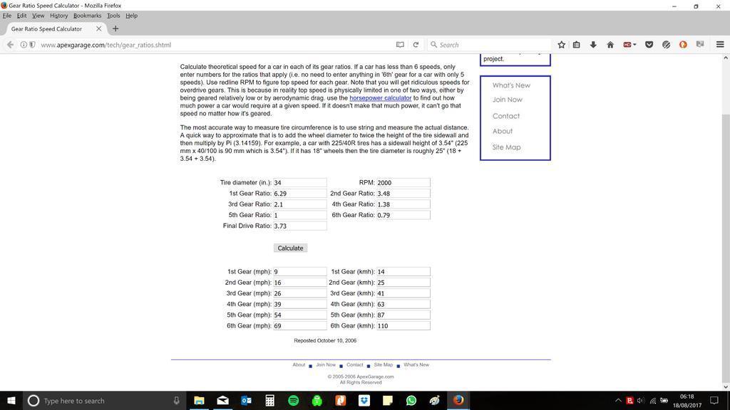

Yes i am aware of the different gear ratios, im not too bothered about it reving so high for the moment, my main concern was geting rid of the junk auto box. I am running 3.73's, for anyone else interested i have attached the 2 different calculated speeds for the AD and AE versions both of them based on 34" tyres. When ordering from Rockauto there is no way of choosing which gear ratio you get as far as i can tell, i will just need to be greatful if i get any G56 :)
