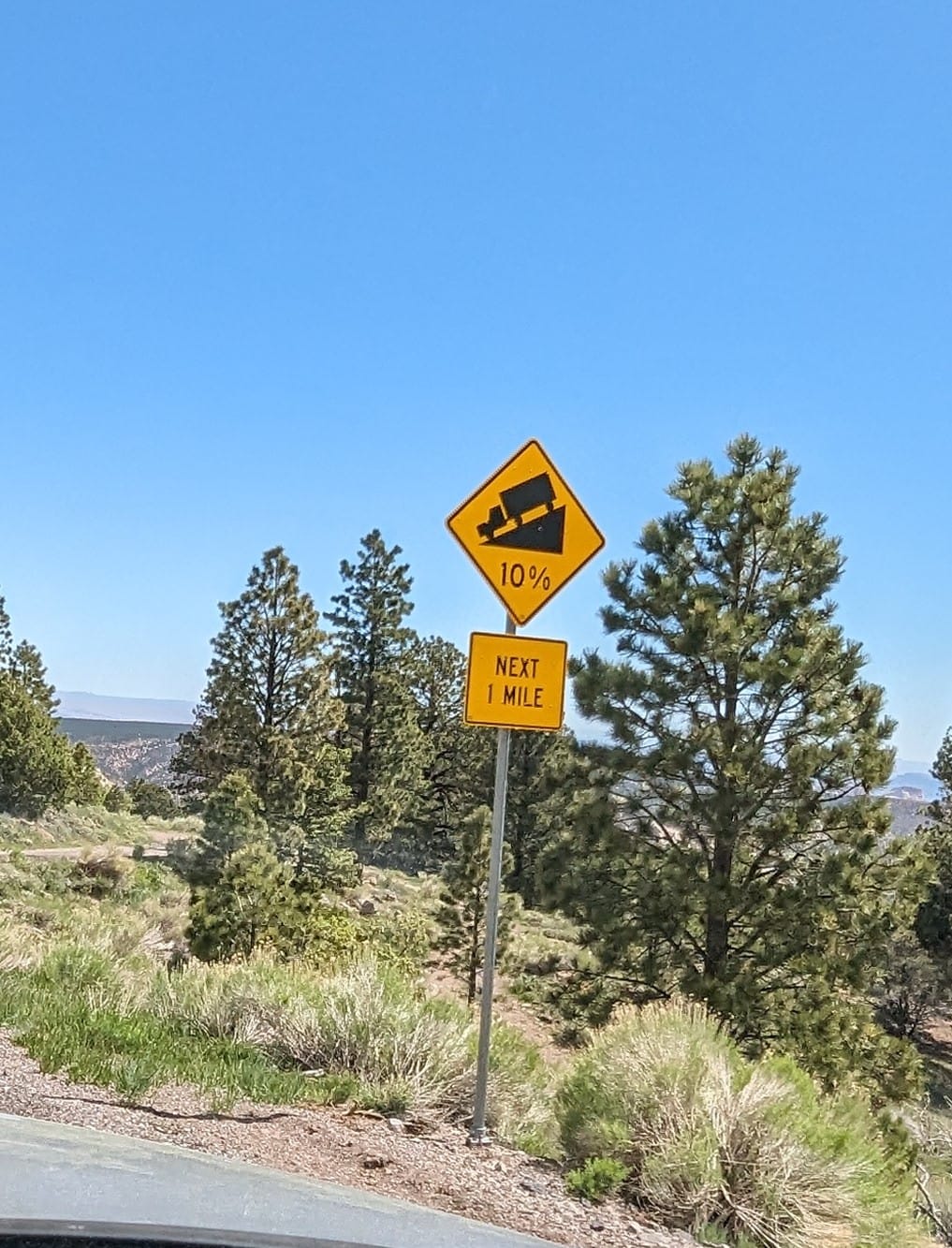

you can assume if the torque converter stays locked the transmission should not overheat on a climb. If no exhaust brake, you descend the grade in the one gear lower than you climbed it and just dont let it get away from you and you can always use a pull out if you need to..
it is the Interstate and not some side route with 10 or 12 % grades.
I would think you should be able to climb The Ike with no issues.. assuming the truck can climb anything else.
you can always stay behind a tractor trailer that is crawling up or down that grade
as well as pull over if need be...

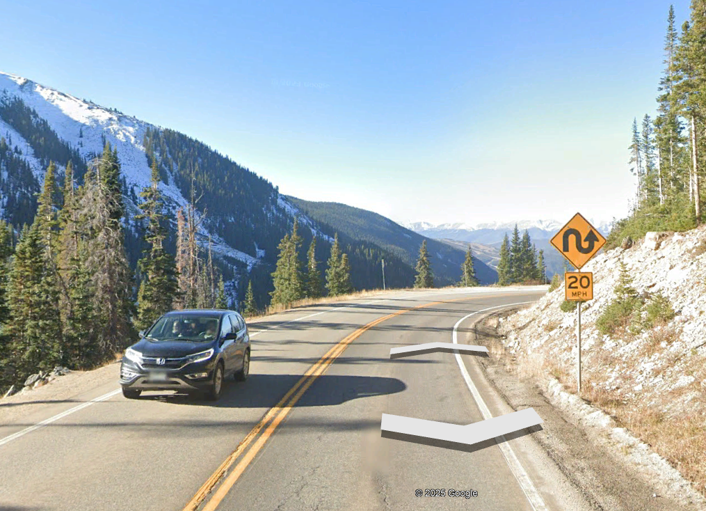

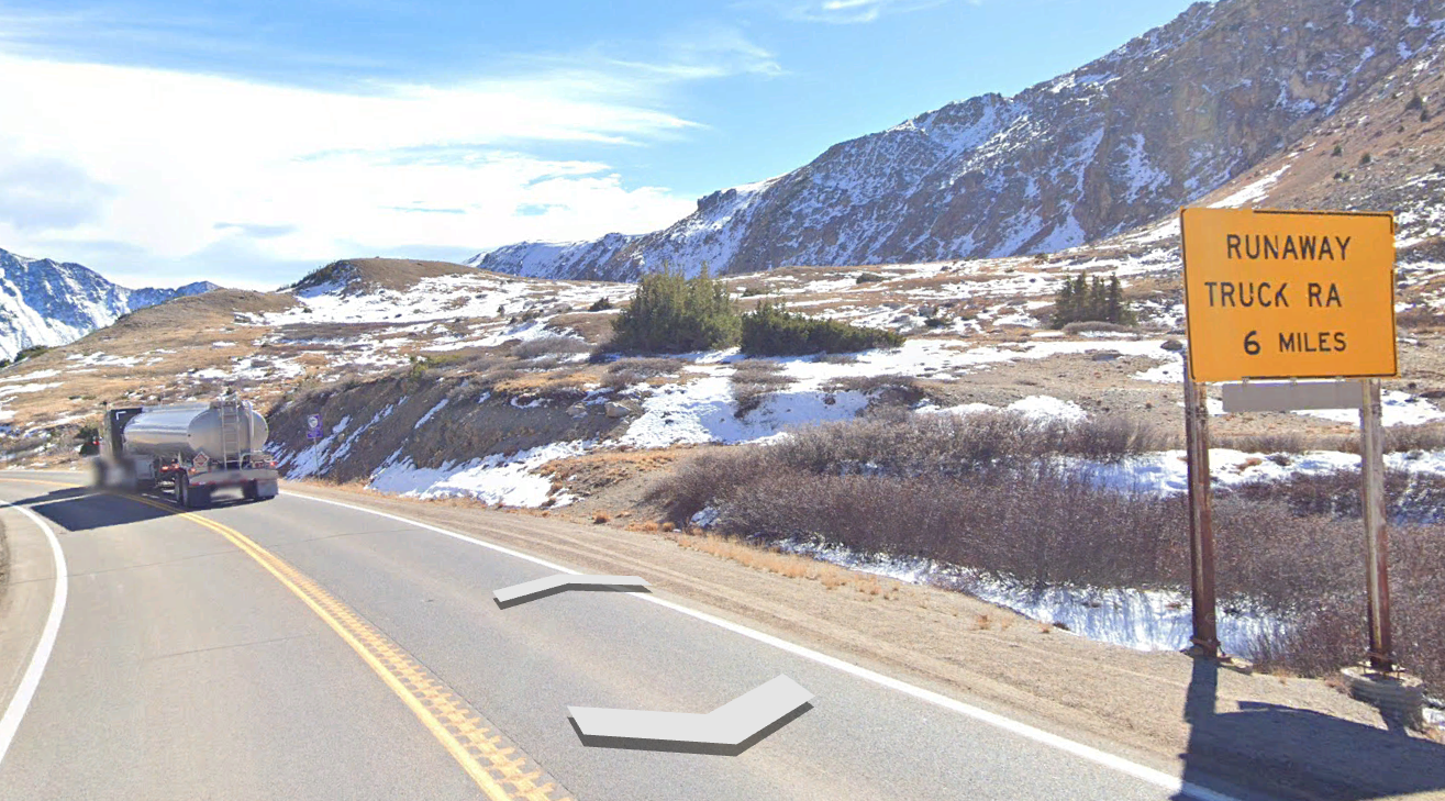

I personally like a bigger margin of safety when it comes to towing on long downgrades - especially when towing at maximum weights or slightly higher, as in the OP's case. Also, kudos to the OP for knowing his rig and asking for advice regarding doing something that he has never experienced.
Who knows, maybe upon arrival at the tunnel, the tunnel is closed and traffic is being diverted over Loveland Pass. It happens occasionally. Now the margin of safety just got narrower. Oh, and you get to start the downgrade at just over 12,000 feet.
A couple of Loveland Pass photos:
- John
