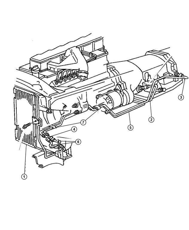

I need your VIN. I used a VIN for a '97 truck to get this illustration.
Also identify the line by reference number.
