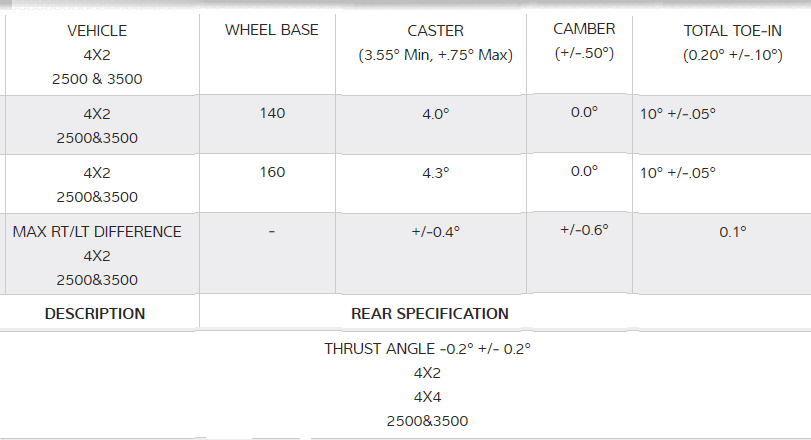

I have searched all over for these specs and cannot find them anywhere on the web so help please. If anyone has improvements over the factory specs please pass along what has worked for you. The issue is front end tire wear on the outer edge of the Michelin LT265/70R17E1.
Thanks in advance for your help.
How's this:
That is too much toe-in and why the tires are wearing on the outside edge. Factory is wrong on the toe in. IIRC, 1/16" or 4-5 degrees is better for wear on the tires and should still drive straight all things being equal.
That is what I told him in his other thread. SnoKing
I thought that sounded excessive. That's what I love about TDR, lots of knowledgeable folks that don't mind sharing. Thanks for the correction, fellows.
