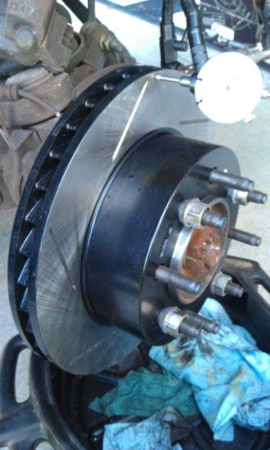

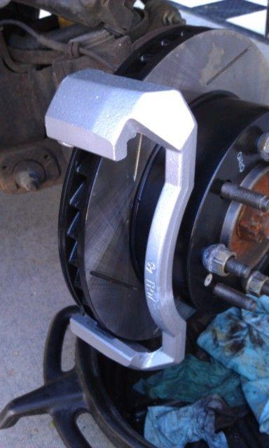

I ordered the Power Slot Cryo'd rotors (thanks, G. Tobey, I added them to my search because of your suggestion) from Buybrakes.com and the Hawk pads they recommend. I abuse my components and am hopeful they're up to the task. I believe they'll be better than the Les Schwab/Autozone ones and at a comparable cost. Powder coated as opposed to painted as well.
I'm getting calipers from Napa and may do front lines as well. Truck's got 276k on it and only the rotors/pads have been replaced, so it's probably time.
They should be here next week, when the real fun will begin!

Rhondasway if you still have the OEM calipers have you considered buying a rebuild kit and doing it yourself? I had to replace my calipers in a pinch the night before a 1500 mile round trip and was forced into cashing in on my OEM units for a set from NAPA....I regret doing it. In 2 years time I have had to replace my driverside caliper twice. Maybe I've just had bad luck, but I suspect like everything else reman parts just don't have the same quality they used to have. A rebild kit is a fraction of the price and you will know they were reassembled with care....Calipers are deceptively simple it amazes me what they charge for a set considering they take yours in exchange....just a thought.
