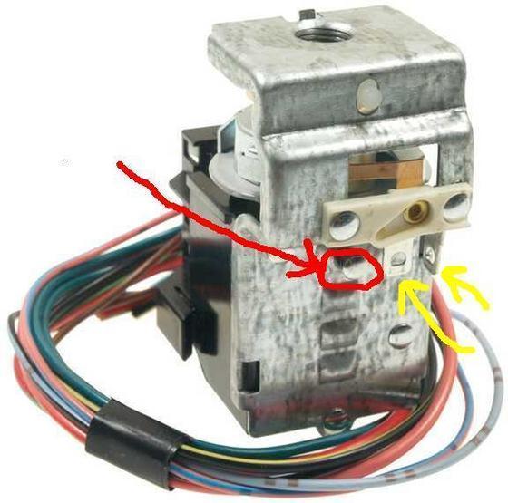

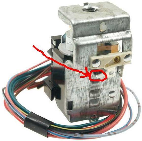

Pull knob out to the headlights on postion, then press the button here as indicated in the red circle and pull the knob/shaft out of switch.
Mike.
