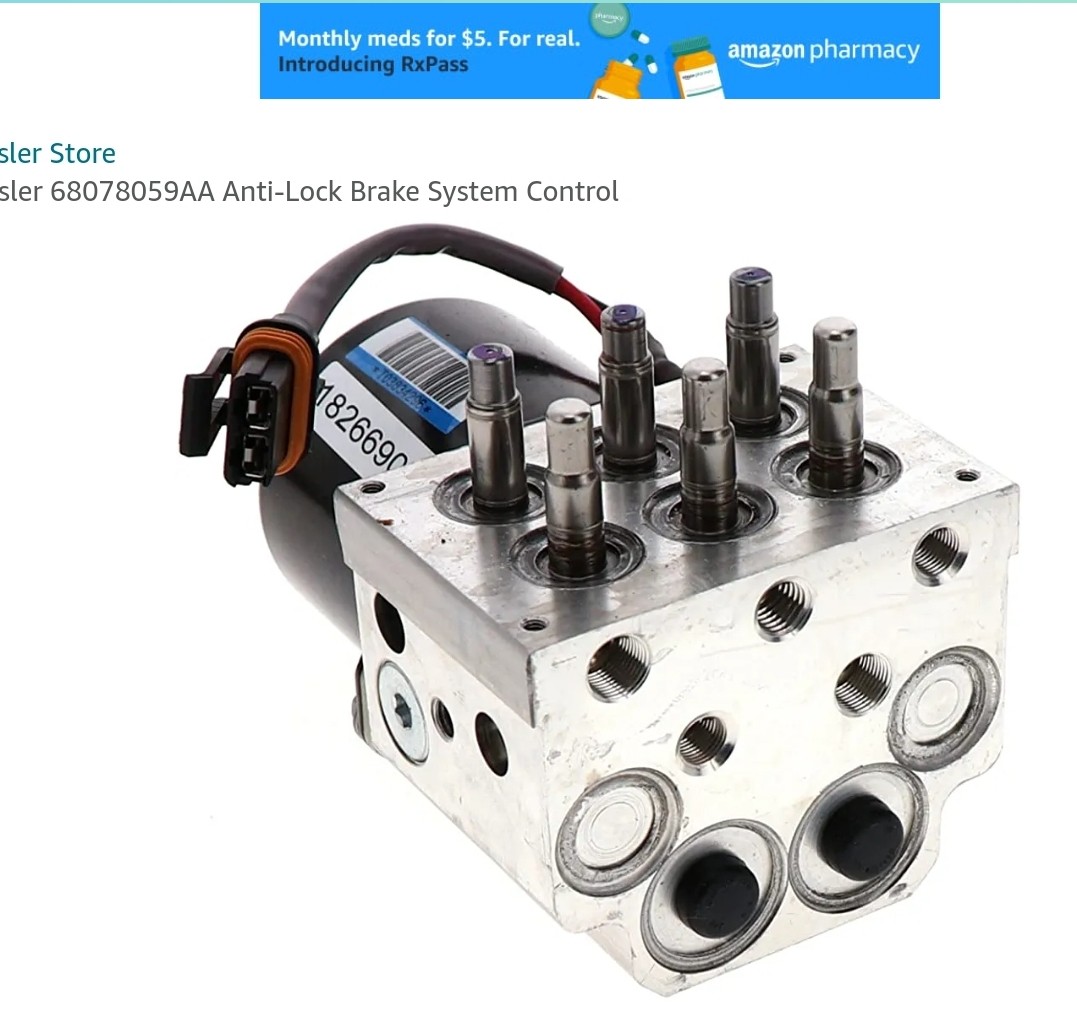

Im working on my brake problem with the ABS control valve unit.
New Partnumber I found is
68078059AA
This is the hydraulic part with the pump only - not the electronic part that sits on top of it that fails regularly. I replaced the top part already many years ago.
It seems to supercede the old Number
52121408AE but I can not confirm this.
I need someone that has access to the Chrysler parts system that can give me Proof that this new unit is a 1:1 replacement for the old number, that there are no additional parts needed to install that unit.
I would really appreciate help here.
Had Quirk run the numbers. 52121408AE supercedes to the 68078059AA, there is a note to use Electronic Module # 5114538AE tagged to that supercession. Do you have the Part Number of the one that you replaced in the past? We could not prove if the module was different, but both of our Parts Man Spidey Senses says the module was not updated...

I've got the 52121408AB, just checked it hands on.
So it sounds like I can attach my electronic module on top of this new hydraulic module.

Sometime back I replaced the top ABS electronic unit with the same one you listed above: 52121408AB. I bought it used from a junkyard/Ebay. Works fine. If I remember, that number was slightly different than the one that came originally from the factory. Mine is a 2004.5.
