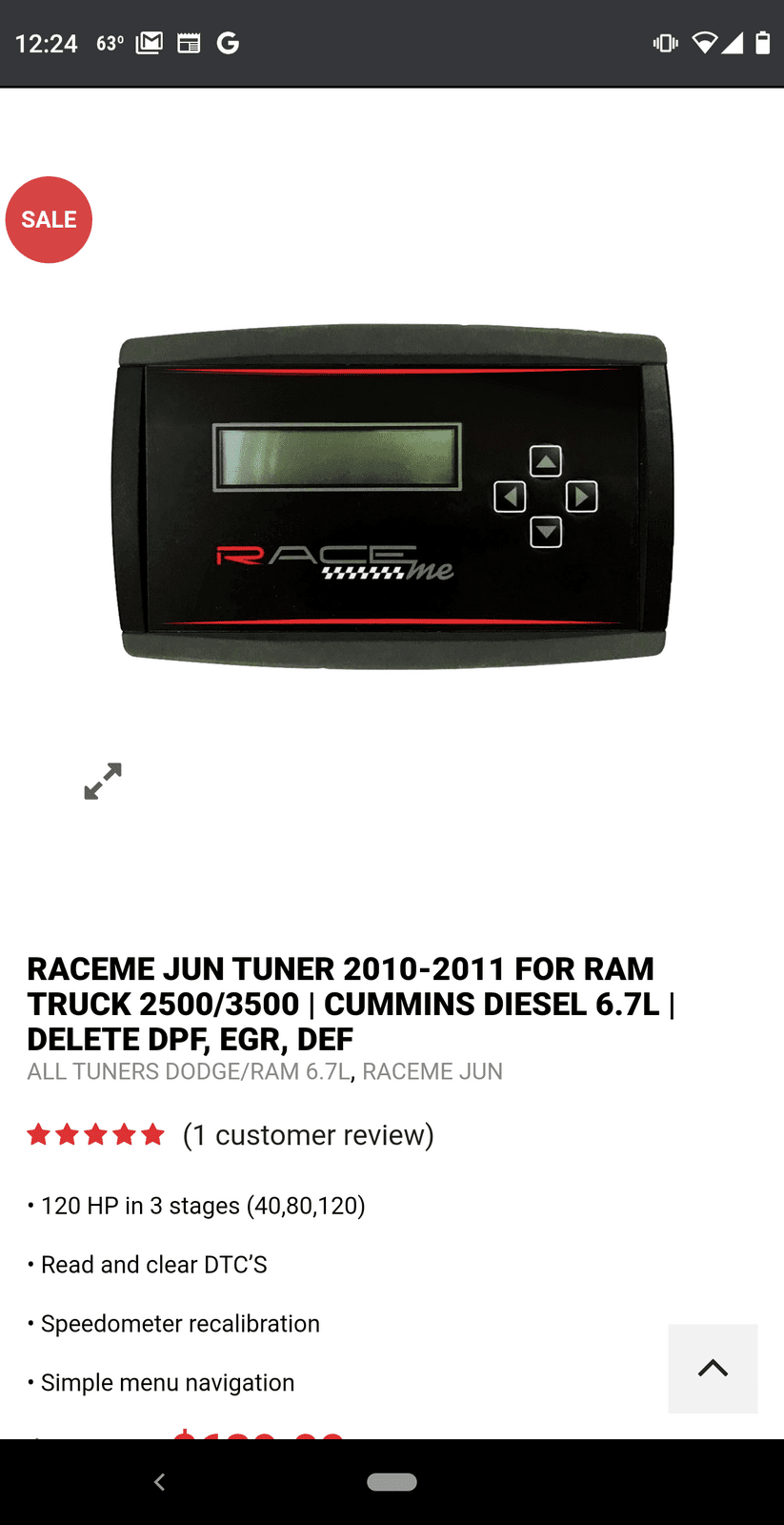

What fueling and timing? I'm not sure. It's whatever the programer defaults to. It's a RaceMe tuner.
Do you have defuels set? Not unless the tuner does it.

Which RaceME tuner do you have? Ultra? Pro? Does it look like a big TV controller? Did you buy a custom tune for it or just use the box tunes?
You need to go thru the tuner setup and see what it is set to and what can be adjusted. If you just pull in a standard box tune and NOT set timing correctly you will eventually just cause a HG leak again. The 6.7's run way too much timing as a default anyway, unless you back it off to stock on a box tune or modify the timing modifiers and adders you will have too much timing that will just add to the issues. Even on stock timing with the timing adders and modifiers the tune still can run excessive timing because it doesn't account for all the changes. You have to pull the delete tune with HP Tuners and start looking thru the tables to see what is actually happening. With an auto trans you won't notice it is much, but, a worn out G-56 will definitely give audio indications what is happening.

You have to pull the delete tune with HP Tuners and start looking thru the tables to see what is actually happening. With an auto trans you won't notice it is much, but, a worn out G-56 will definitely give audio indications what is happening. So, I have never been to happy with the RaceMe tuner. It's what I believe they call the Junior model. It does have the ability to do some type of timing modification, but I've not messed with it.
I see you mentioned the HP Tuners. I this something that ultimately can replace my RaceMe? I'll be honest I would love the ability to do custom tuning, but I really don't have them to to learn it right now. Need something that I can get a custom tune from someone that knows. Is that something that HP Tuners can do?

It depends on what the RaceME does to the ECM like locking it. With an S67 we grabbed the existing image in an 07 ECM, unloaded the Smarty, reloaded the ECM with HP Tuners and the delete image all stayed then we could custom tune things. My son is working all that out but we have a highly modified engine also, colt Stage 3 cam, HE451VE turbo, wider rings gaps than stock because the issues we found were the rings touching and scoring the cylinder when they got to hot.

I was just thinking that if I could just get a custom tune via HP Tuners, then I could just sell the RaceMe. Doesn't sound like that's an option. Oh and did I mention that the wife is having a fit about how much this is costing? :) She is trying to tell me I should have just bought a new one.
