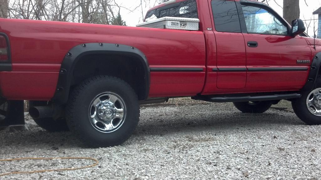

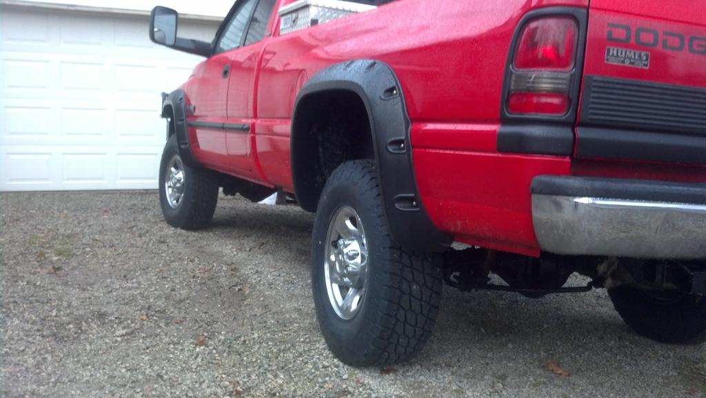

The paint on my truck is still in great shape but I was starting to get a lot of road chips along the rockers so before it started to rust I decided to coat the bottom 4 inches with Monstaliner. It is a DIY bed liner and in doing my research seems to be about the best bed liner material available to the general public. It is a true epoxy and the texture comes from either spraying with a shutz spray gun or their speciall rollers that they send with the bed liner. They have many different colors available to choose from.
Not the best shots but here is ar few of the Monstaliner along the bottom and my bed rails
You could...however this is no different from any paint system and proper surface preparation and application is very important, otherwise your not going to be happy with the outcome or it may not be as durable as it is supposed to be. For example, I dinged the snot out of my tailgate right at the top took it down to bare metal and bare metal around here equals rust. I had a little left over from when I did the project so I figured I would use it and come down the same distance as I did when I went over the bed rails. It was getting cold out and my furnace in my garage was out of commission at the time but I went ahead and sprayed it anyway...left it sit in the garage for 2 Whole days and it just never felt like it totally hardened up. It was dry to the touch but I could dig my nail into itwhich I can't do with the other parts I painted. I even tried a heat gun but I don't think it did much. Had to have my truck so I went about my buisiness and was careful to not do anything to damage that particular area of the tailgate. About a month later I was pressure washing the truck and got into the tailgate and it lifted part of the monstaliner. The other parts have been great and given me no problems so temperature and surface prep are key to a good finish.
