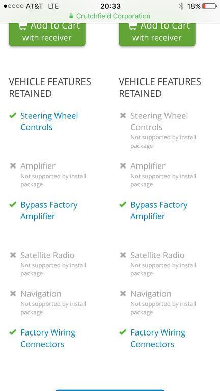

Search Crutchfields website or simply call them with your info and questions. Their database as to what fits any specific truck with any specific oem stereo system is very easy to use and more importantly very precise. They also have excellent customer service, a 60 day no questions asked return policy as well as excellent tech support for installation questions.

Crutchfields has a great system for matching what fits, and shows integration devices but the only issue I see (besides spending $) is utilizing the amp (I'm RAZ with the still awesome infinity system) and the steering wheel controls. If anyone knows of a system that retains both, please refer it!

They should gave an adapter for the steering wheel controls. Might even have something to retain the amp. If you can't find it online give them a call.
Open the link I provided and if you look at the assecories, you'll find that steering wheel controls and amp still work. But you'll loose front to rear separation of the radio. I haven't noticed any difference in sound, except the front to rear operation, you'll still hear from all speakers.

The Metra adapter I see is to integrate the wheel controls but bypasses the Infiniti amp. I was looking to hold onto both. I only want to change the head unit.
