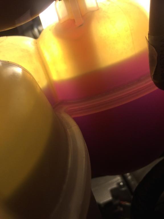

As some of you know, I lost the water pump on my 2013 RAM 6.7 on vacation 07/18/2016. Truck has been in dealer (Hatch Bros) in S/Az since Monday 7/18 for water pump repair. Going to pick it up today finally.
I know the water pump, hoses, fan etc were changed by another dealer under 30K miles as the first owner complained about the high temps it was running when towing, as I did/have. Dealer answer, "within specs" blah blah..got it. Mag-hytec pan pulled 20 degree's off transmission, but engine still runs to hot IMHO...;) And MHO don't count..LOL

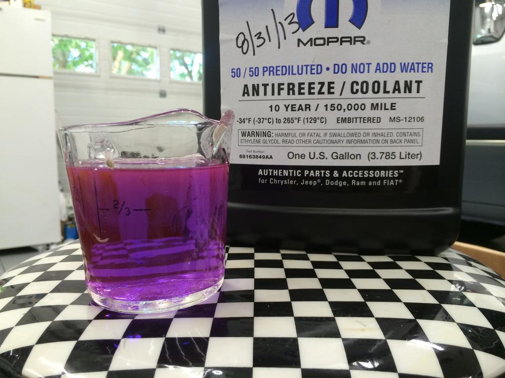

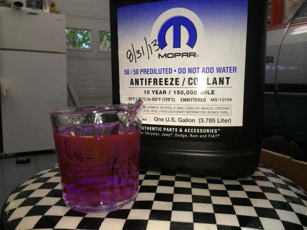

What type of coolant/part number does the 2013 and up use? I know its a "OAT" and not HOAT as before.What color is the OAT coolant ? I'm beating my head against the wall trying to figure how the pump would go south in 30k miles....I want to pull the trigger and get rid of this truck as I have lost all my faith and confidence in it. Still debating yah nay etc.
What if anything would using the wrong coolant do? Hotter temps,lower temps etc ? Seals go out etc etc?
TIA

This is what your looking for.
