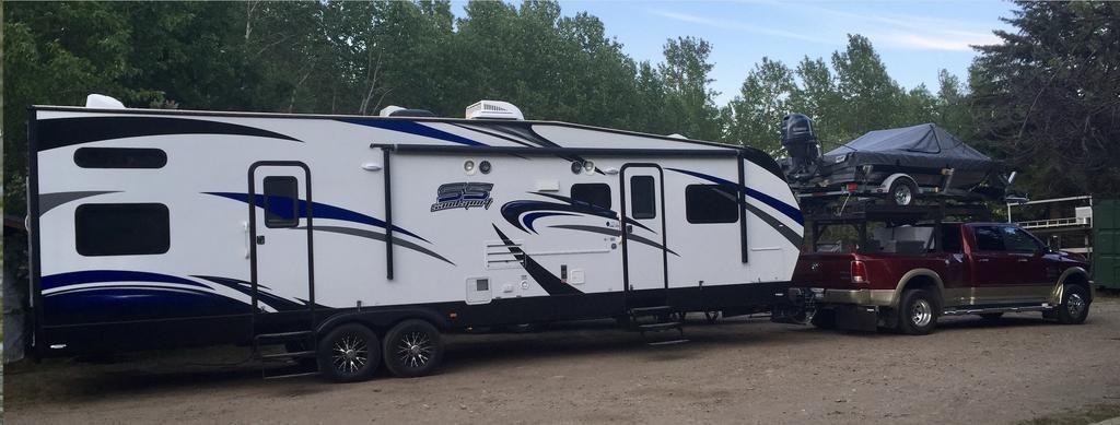

I had a lengthy conversation with two DOT officers in BC this spring about such load issues and it jives with what the link says for the most part. They said that it comes down to their judgment of the load. If it looks unstable and overloaded they will deal with it but if it looks good and the tires are not past their ratings they usually let it go. I was explaining my situation of being at 10,450 lbs on the rear axle when I have my boat on my truck with the RV hooked up and the door sticker says 9750 lbs. They said I'd be fine as the tires are good for 12,000ish lbs and my truck's stance is as if it's empty.(the rear is a bit higher than the front) I also questioned them on the fact that I added a third axle to my toy hauler trailer and therefore it doesn't match up with the gvw stickers on it as well and they said that the would do a quick visual of the trailer in this case at the workmanship, weights, tires etc. and send me on my way if I was checked out. There isn't an engineering requirement on a private RV like there would be on a commercial unit. Tire ratings are usually king unless things "look" dicy.
The trailer in the picture now had a third axle in front of the other two.

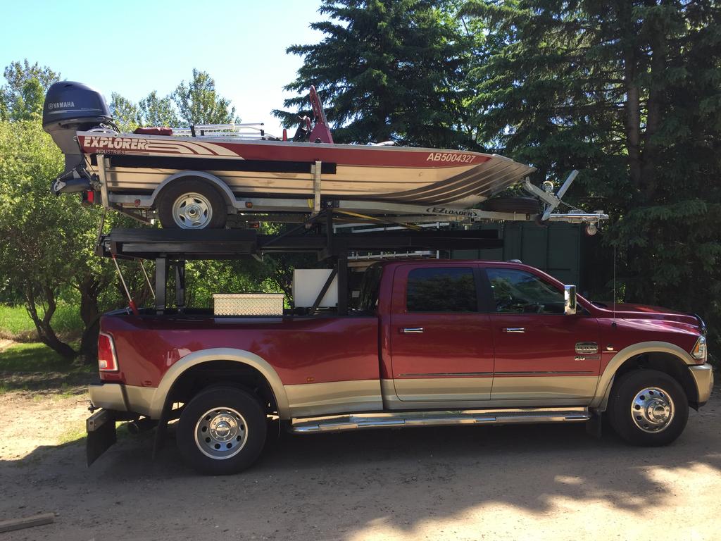

I gotta ask the question... How do you get the boat down???

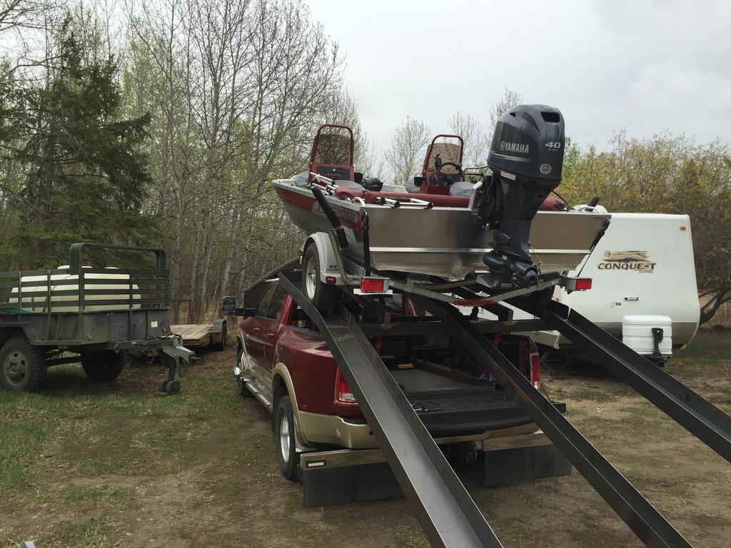

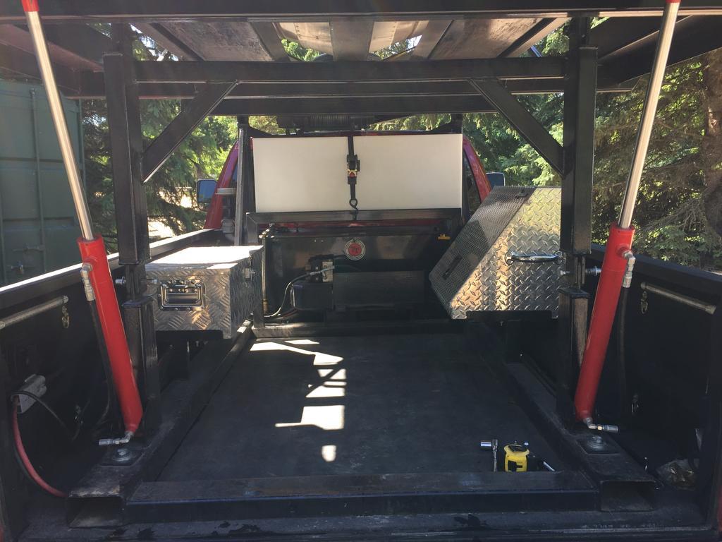

The rear of the rack lowers hydraulicly and I have ramps under the boat that slide out and a remote control for the winch which rolls the boat back down the ramps to the ground.
This last photo is from my trial run of the unit before I finalized the ramps.
