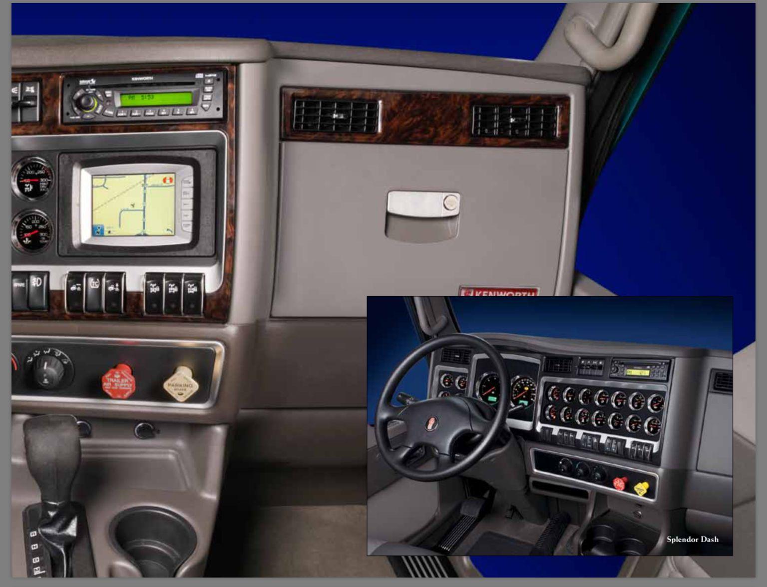

Even a European Class8 has no more then 2 Gauges and an EVIC, gone are the Times of 10 Gauges.
#ad
The US Version on the other hand is still loaded with gauges.
#ad
Ozy is right. About 10 years ago, the HD trucks started putting information in a display on the dash controlled by switches in the wheel or signal stalk. However it’s nice to know that in the big truck world, you can still get a traditional dash in a premium truck. Wouldn’t it be nice if Ram made that an option for us?

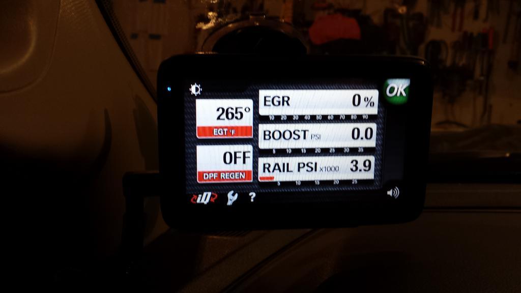

Information and knowledge are everything in the engine world, Now you can disregard engine info, but thinking that parameters set by the maker are a protection LMBO, is like calling the fire dept after the fire is flaming. Gauges allow the owner from allowing the fire to start. Plus any commander center will display the the code or warning, without the need to stress over the worst case scenario.
