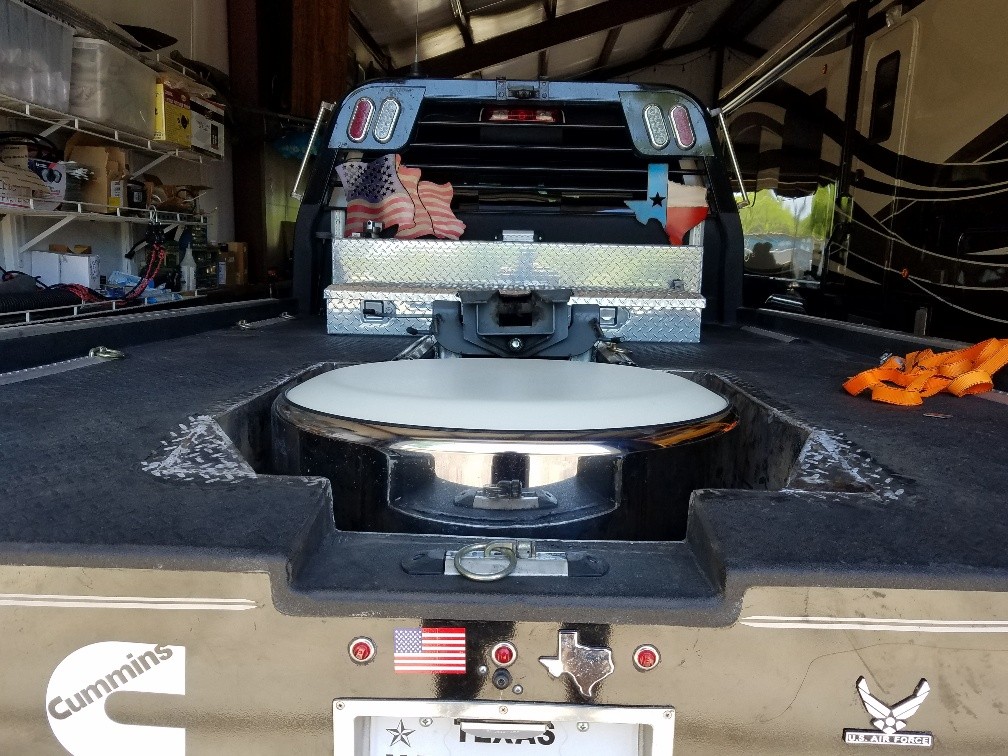

  4. I does not have the 5th wheel puck option. But was going to ask if they can put one in., I added them to my 2015. I believe 2500 are easier to add, bed does not have to be lifted.
