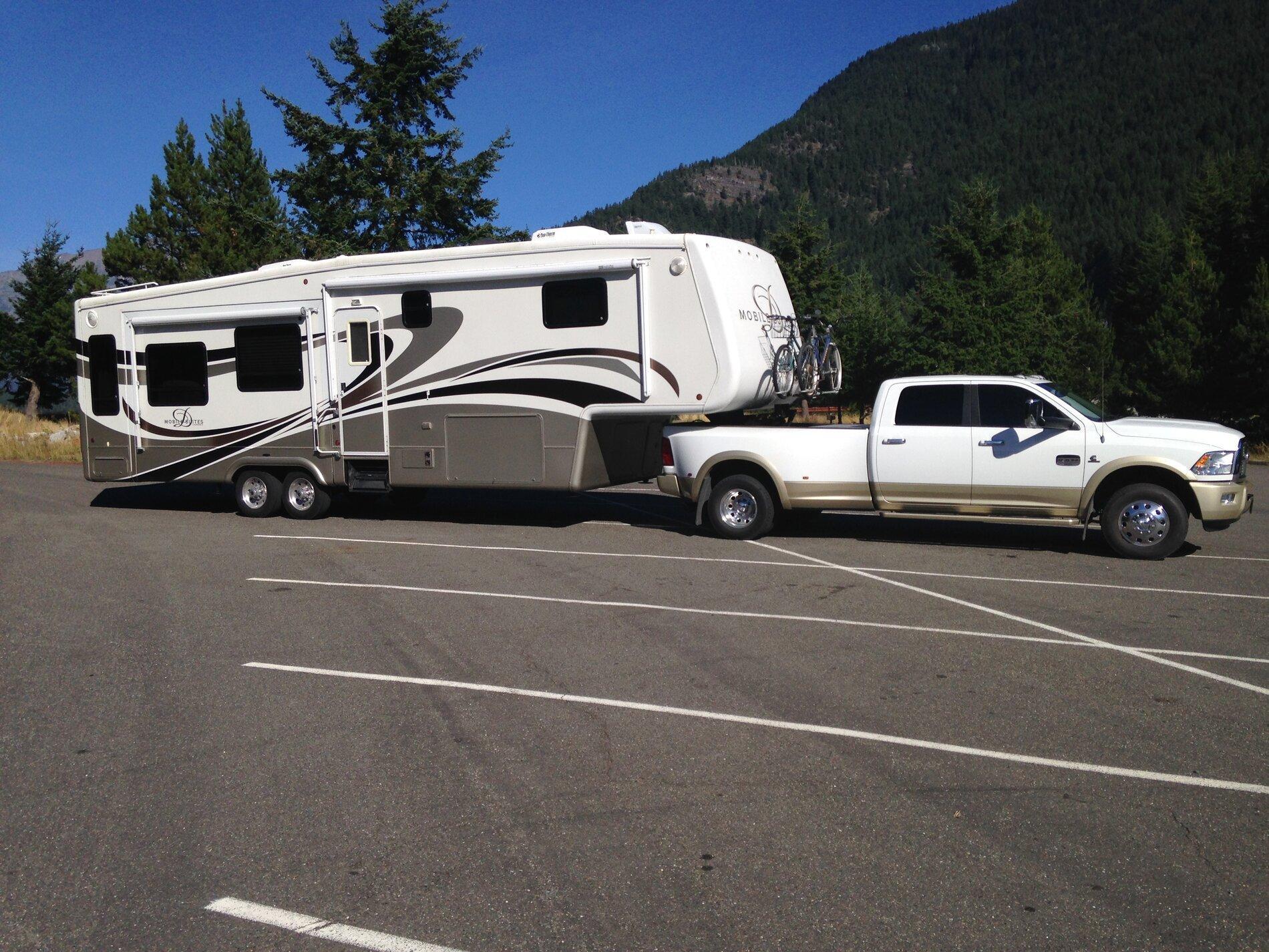

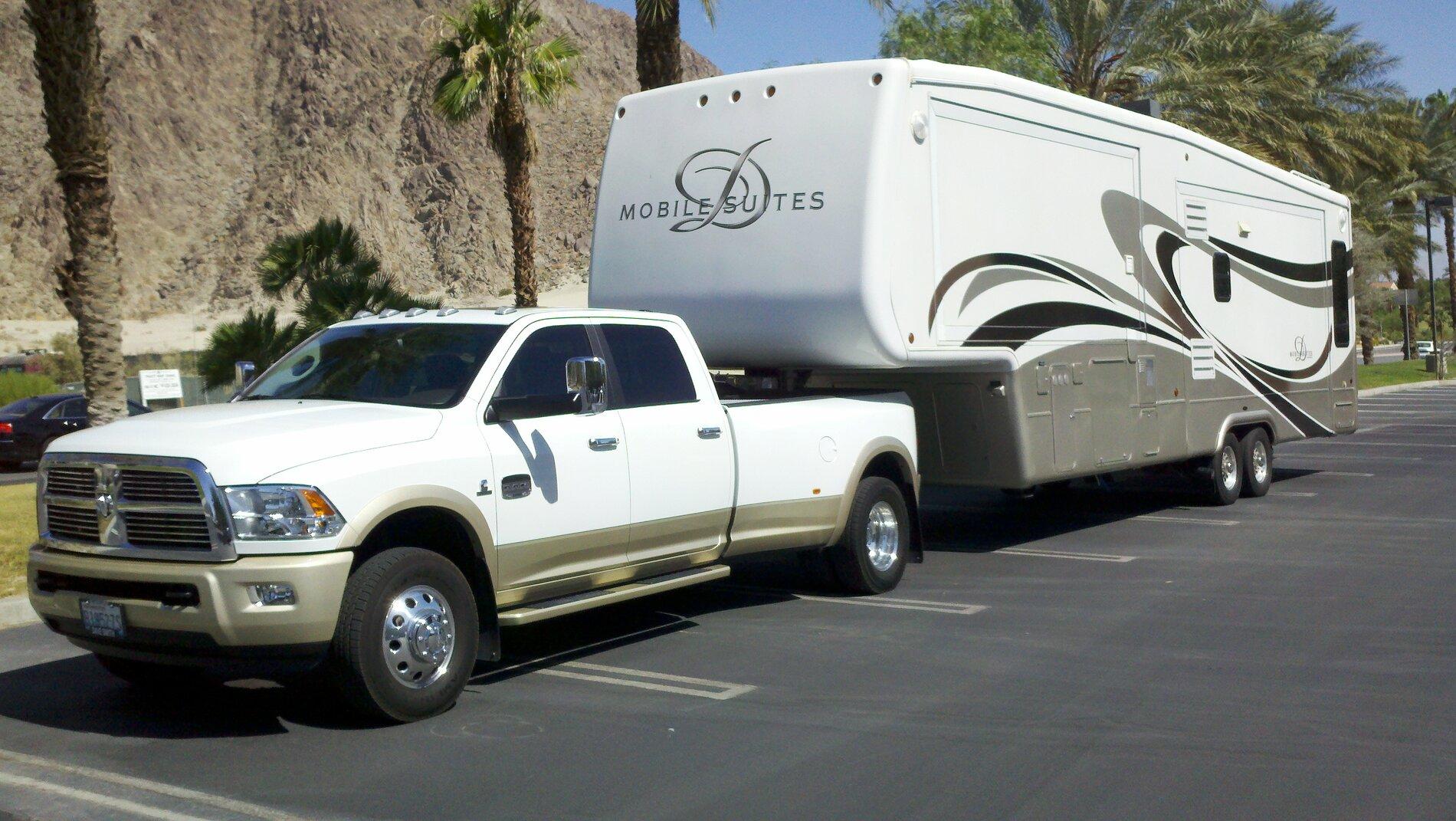

First pic nearly a 5k pin my truck sat level, no bags. Second is with bags and 30# air when loaded. Incredible ride difference.
