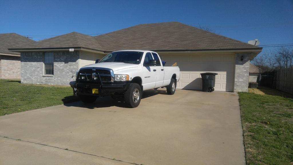

So i finally went green pump last week and picked up an 03 2500 with a nv5600. The truck has about 212k miles on it and from what i can tell is stock and was pretty well taken care of. Because im new to the diesel world i was looking for some input on things i should look out for and or change out as preventative maintenance on the truck. First thing i wanna do is fluids, filters, and hoses then a new injection pump. But aside from that im kind of lost with it. Any help would be great! Thanks.

Oh yeah we need pics.!!!! welcome to the forum.

Good looking truck.

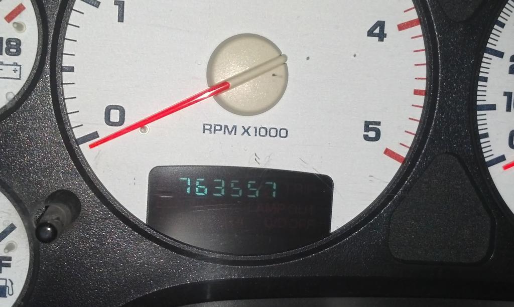

Maintenance, maintenance, maintenance, That is the key, I drove my 03 to 750,000 miles, and i didn't replace cp3 pump ever, lift pump was my down fall, but only once, I'm an Amsoil guy, I believe in it, I have the miles to prove it, keep an eye on the HVAC, had that bite me too, but did the metal door replacement , and it lasted a long time,

Welcome to the TDR! Have you checked engine hours? Turn key on and then hold down trip reset within a second. It'll be in the odometer.
