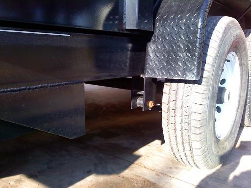

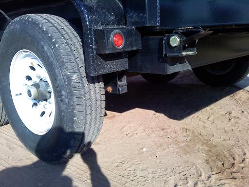

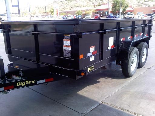

After a major screw up on a new dump trailer my son and I had built this summer, I bought another one from Big Tex. The orginal is still too small for my Bobcat. It is (my Bobcat) a full 77" wide, the new one (trailer) is 75. 5" wide (title says 77"x14') so I figure a mis-comunication between my son and the builder and turn it over to my son, it fits his Bobcat. Then I buy another new one, (7'x14') with the left side suspension installed wrong. The front has the rear spring hanger welded on and the rear has the front... . how does this happen? It must have been overlooked by at least two installers, the person welding the hangers and the axle installer, maybe even a final quality control inspector?
It wouldn't be so bad but after calling all day, I have yet to get someone from the dealer to call me back with a solution. The dealer is the largest in the southwest, you would think they would be on the ball.
If you notice in the pic's, the slipper spring pad (6" hanger) is on the front and the front hanger (4") is on the rear. So now even after it gets fixed, I will have a used trailer. It is impossible to cut off spring hangers and re-weld them without some damage to the frame and hangers. Sorry for the rant:confused:

My unsolicited opinion is for you to call Big Tex directly and explain the situation. The dealer will need the support of Big Tex as well so you might as well go to the source. Have pictures at the ready to e-mail, and explain that you DO NOT want a reworked trailer. If it were me I would politely request another trailer (I assume that you have not used it yet) and the mis-manufactured trailer can go back to them. It is really not fit for the road in it's present condition.

Ok NOW I see what you are talking about. The 4" and the 6" brackets are swapped. It'll be interesting to see what they say about this.

MChrist, the main reason for different hangers is axle placement under a particular trailer due to spring capacity/length, equalizer style/length, tire size and clearance of all moving parts. They also must be the same left to right and front to back.
My trailer has a 4" eye type on the right front and 6" slipper style on the right rear, the way it should be. But the left side has a 6" slipper/eye type on the front and 4" eye style on the rear. Can you see now what this would do with spring level v/s frame level v/s equalizer articulation?
