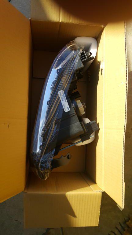

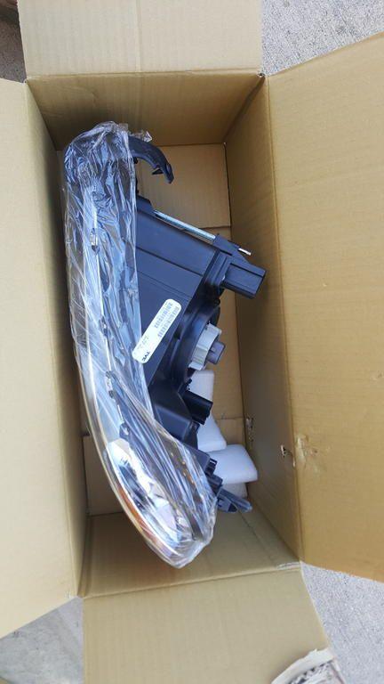

I replaced the head lamp that was broken by a car passing the other direction PART OF LIFE I GUESS!!
in doing so I broke one of the electrical connections for the turn signal. Rather that splice another connecter in place I was wondering how far back in the wiring loom I would have to go to find another connection & if I could actually buy that part of the loom?
On a second note I looked at Geno's for replacement :eek:
I then went to Rock auto for replacements, the price was around $100.00 for TWO!!!! TYC brand headlamps
Pig tail for the turn signal if you can find it. The $100 or so headlights I bought, junk. Oh, they are clearer which was the problem with the old ones but the mirrors and beam quality are terrible. Hope these are better than what I got.

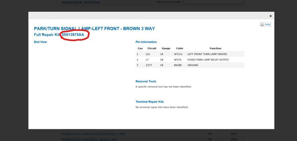

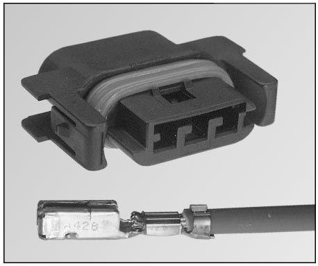

This is the connector repair kit I think you need for the parking light socket connector....same thing, left or right..
Mike YOU DA MAN!!!!! exactly what I need, the contacts are good its the plastic clip locking points that were brittle at SUB 0 temps. Everything works fine it just leaves me with an uneasy feeling that the clip hasn't some kind of locking clip.
Cerb the lights are just as good as the OEM, my OEM weren't bad or dull its just that the lens was broken so in looking I figured id replace both. NOTHING disturbs me more than someone with unadjusted, only have BRIGHTS and driving with fog lamps on when its crystal clear.
