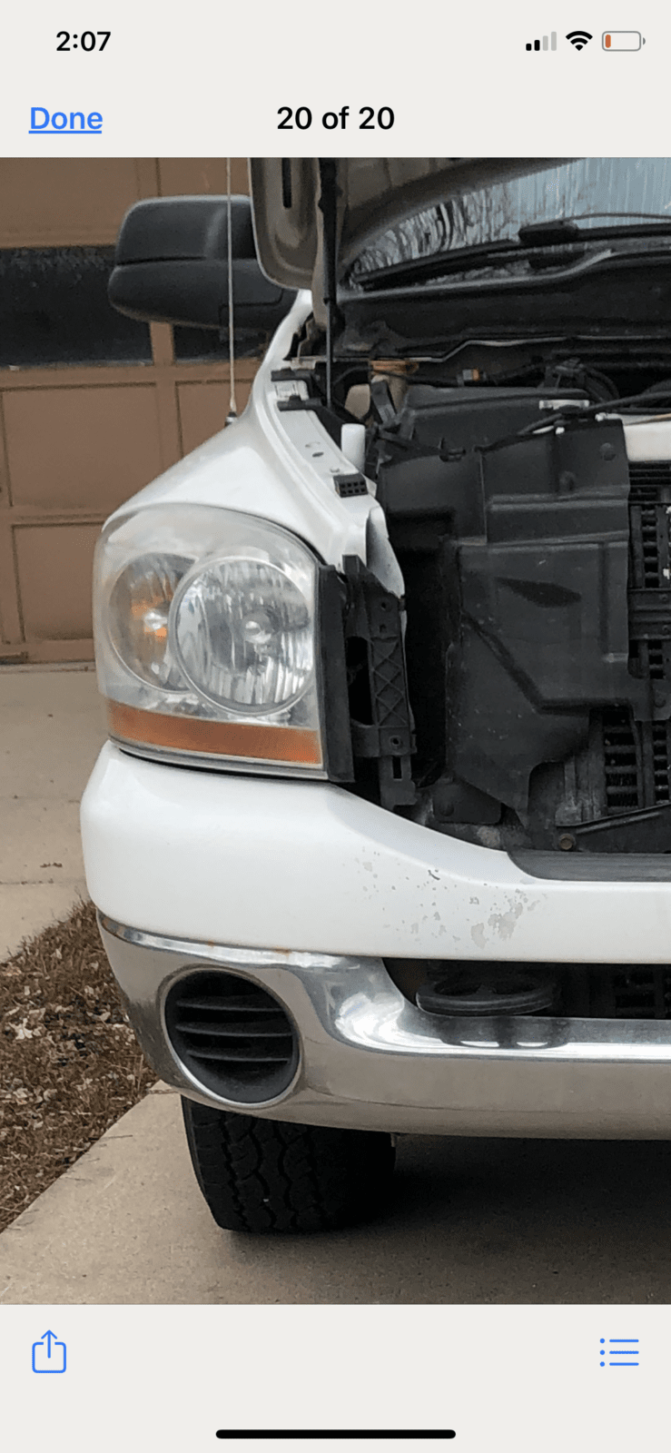

I had to remove the top bumper cover to get my driver side headlight assembly out, the passenger side slid right out towards the radiator with no problem.
Probably easier and less chance of messing up the bumper cap if you just loosen the bumper brackets at the frame and let it down. Just six bolts, if I remember correctly.
