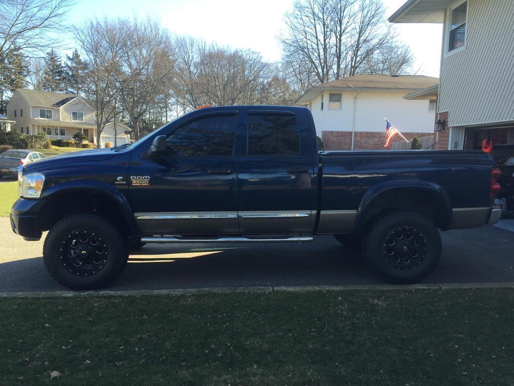

I always see Rams and HD ford with tires that look much bigger and wider. I wonder if they regear. Not the best pic, but here she is...

What other people do has very little to do with it.I run 37's and 35's both sizes are heavy,the 37's weigh a good bit more than 35's.There is a fuel penalty running the 37's even with the 4.10 gears I have.The 35's are better for responsiveness and towing but the 37's are better off road
No 34.84 is not 34.84 mounted on the rim and truck. If it runs as most of them do it is probably 33.8 or maybe close to 34, have to measure it. With the 6.7 that should be as close to a balance of power and efficiency as you can get. Without a tuner and recalibration it won't feel right as major parameters are off.
