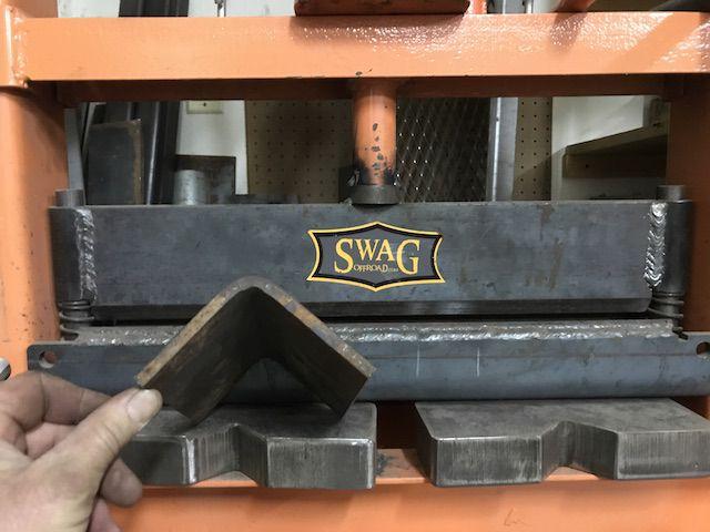

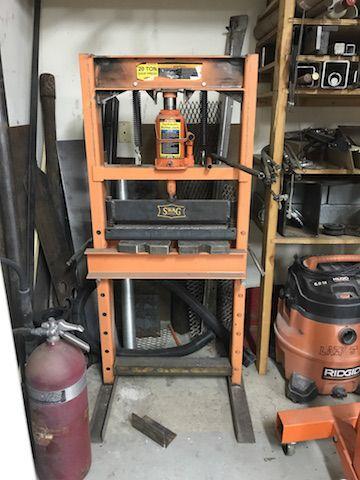

Here's my HF press with SWAG accessories.

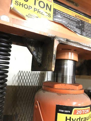

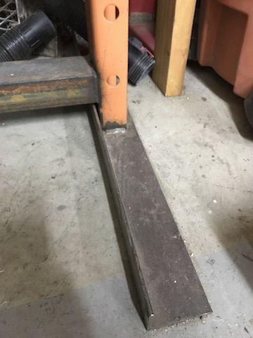

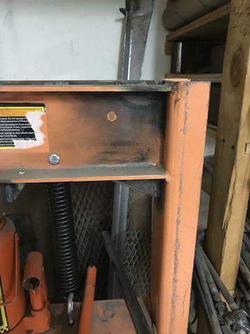

I re-inforced the frame with 3/8" plate and I also cut off a built my own base.
Nice job on the mod. Looks good. I will look into the swag plates. Mine are one inch steel. The were definitely cut with a plasma cutter and are heavy steel, not cast. The arbor Vs and semi-circles were ground smooth as well. Also, they have changed the color to grey. I’ll check out the arbor plates when I get time. Thanks.
