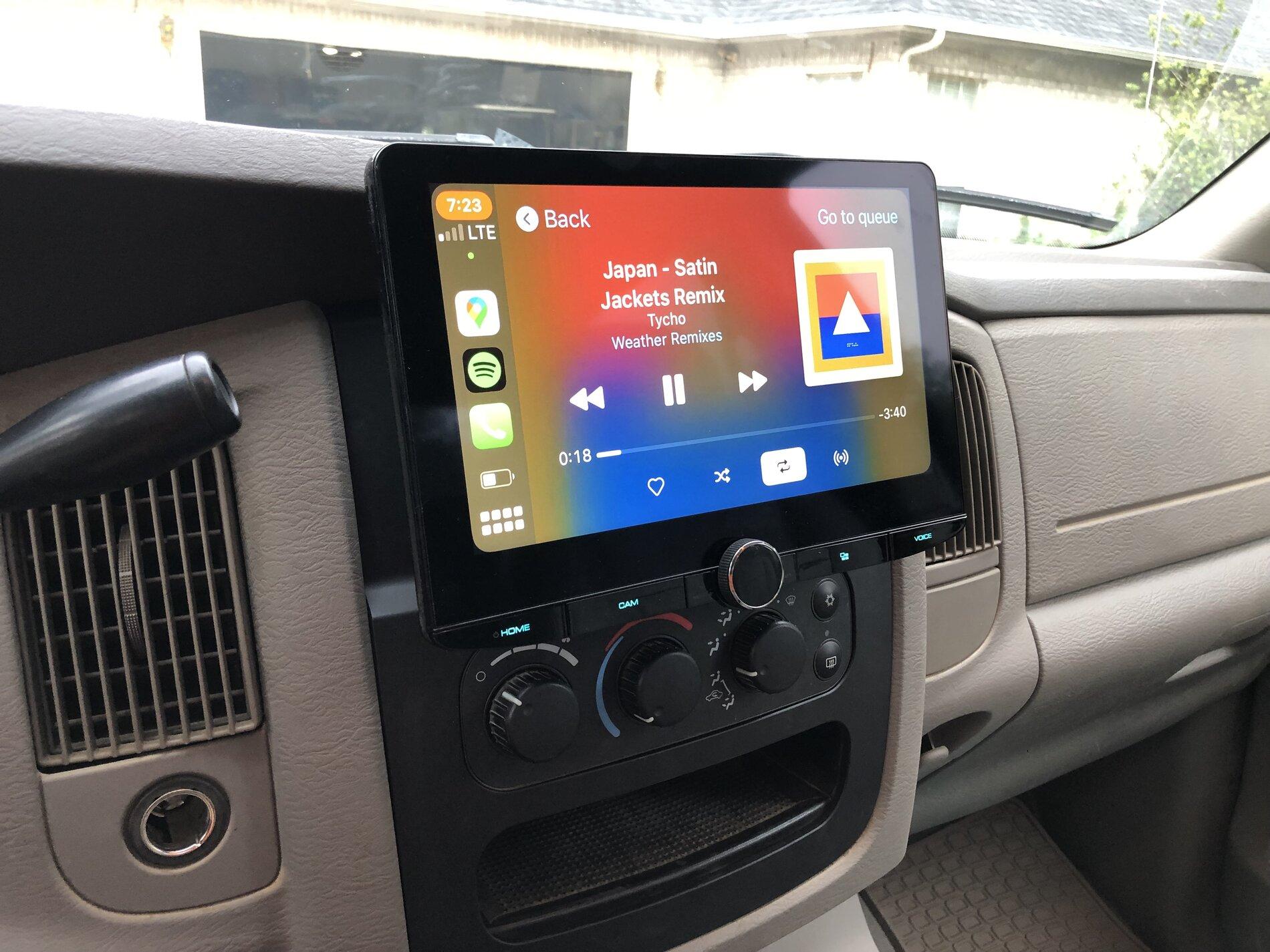

I installed one of these in my 04. Very, very happy with it. Added a reverse camera built into the tailgate handle, but the unit has an input for 4 cameras IIRC. Apple car play is nice, as is voice command, text read, NAV...most all items that a more modern vehicle would have.
Install was fairly straightforward. It needs the VSS wire input but a quick interweb search found that. I paid a few bucks extra to have Crutchfield build me a custom wire harnes so it was almost plug and play. I had to find the aforementioned VSS wire, and the parking brake wire.
There is also a plastic "ridge" that needs to be removed from behind the head unit from the dash. I spent some extra time getting that cut just right so the head unit can sit on it for support which makes for a very solid mount. The GPS antenna is under the dash cover- very easy placement.
This unit keeps the truck much more relevant as far as modern electronics go. Not cheap, but very expandable if needed.
