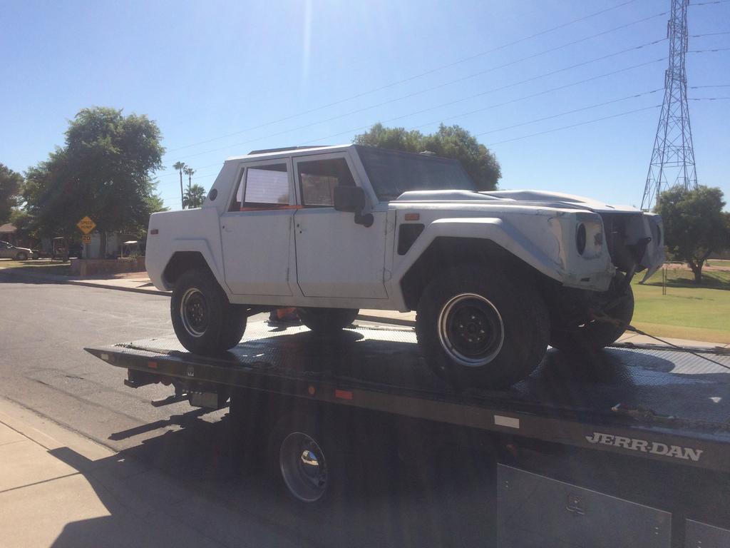

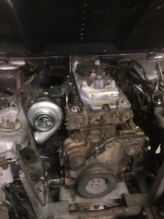

About 2 years ago we bought a 1989 Lamborghini LM002 that had the original engine pulled out to put a Mercedes 5 cylinder in. When we got it we knew that wasn't the direction that we wanted to go so we made our measurements and landed on a common rail cummins. We are looking to take it to Sema either 2018 or 2019 depending on how funds and parts work out for this thing, but either way we are continuing forward on it. As it sits we have the engine mounted and a trans is on the way, so hopefully everything runs smoothly from here (which never happens!).

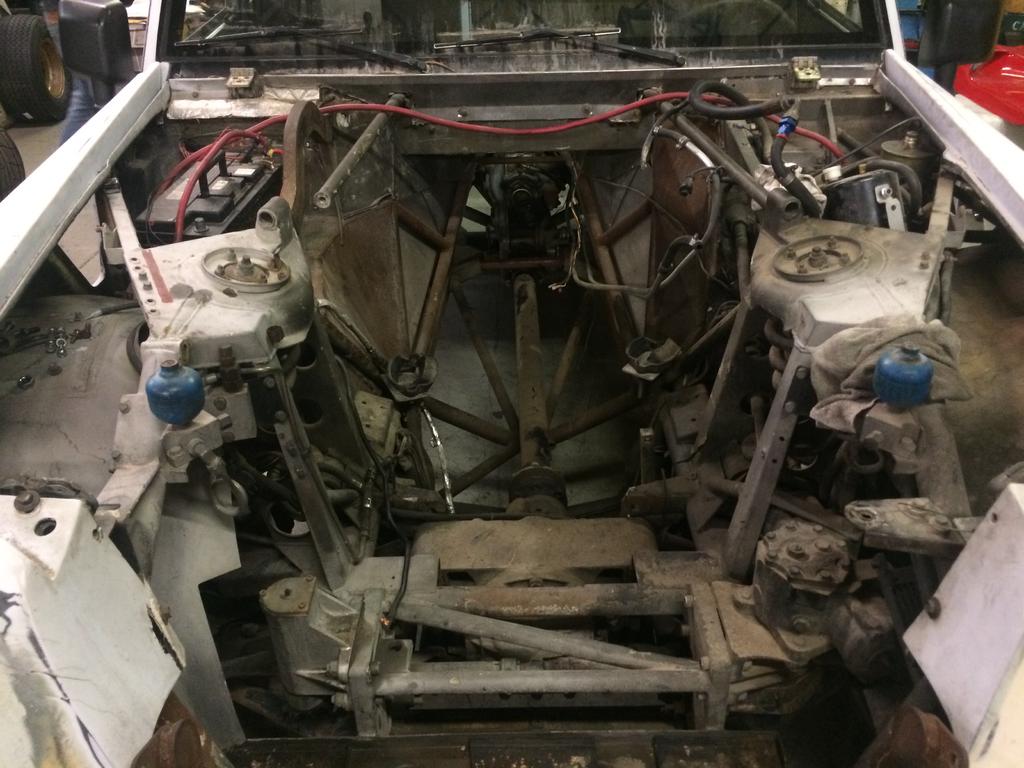

Here's a few pictures of where we are at on this project

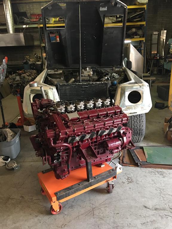

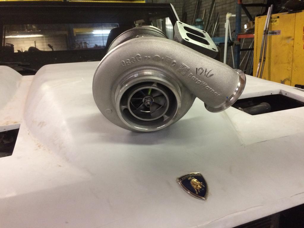

The alternative engine came in over this last weekend. We bought a period 9 Liter V12 engine that was out of Lamborghini's Marine division. The project still makes the most since with the cummins but we have a special tandem project that this beast of an engine is going into and will forever be paired with our LM.

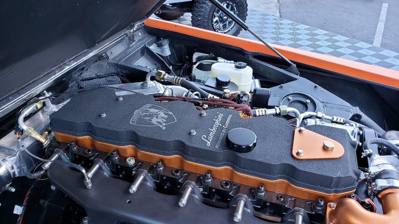

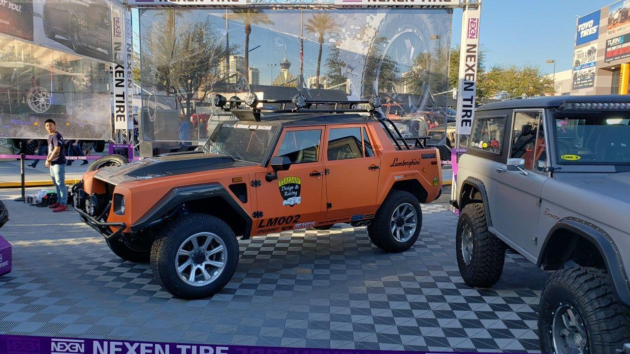

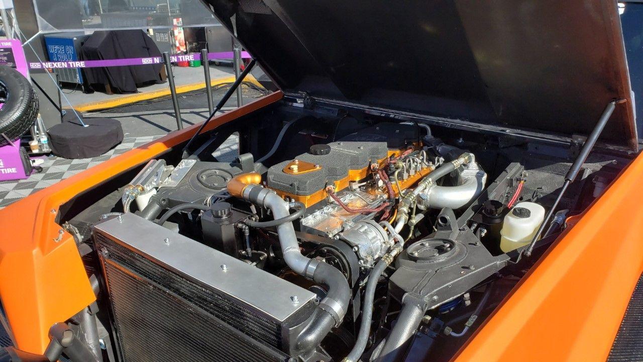

Well we have been in a made rush after our busy season taking 3 of out Ferrari race cars out to Monterrey car week in August our wheel manufacture contacted us to give a last minute spot for the SEMA show in the NEXEN tire booth. We were blessed with 15 sponsors that came along side of the build in various forms and we are extremely grateful for their help. That being said we may have bit off more then we could chew to get it there but our small crew did with just a few things to finish up on it now that SEMA is over. I have lots of pictures of the build but not enough time to post them all since now the customer cars are having to take priority since we closed up for 8 weeks to get this done. This was a huge undertaking for us in 8 weeks as all that we had done before that was fit the common rail engine. We had a large learning curve for this project especially not being a truck or diesel shop but we are proud of the product that we have turned out and we are excited to finalize it and start using the truck!
Here is a little about what all we ended up doing.
Engine and trans:
2003 Cummins Common Rail
Nv5600 6 speed with a short shifter and custom billet arm
Southbend dual mass clutch
HTT 68mm turbo with a billet compressor wheel
Steedspeed billet exhaust manifold
Hellmann billet side draft intake
Dual Freon cooled inter-coolers
Quadzilla tuner
Custom engraved valve cover
BD diesel injectors 60HP
BD diesel injection pump
Fass lift pump
Custom full stainless exhaust
NP241 transfercase
(3.08 diff gears to come) Hoping to do 175MPH in the truck for sure higher then the 140MPH that the original did
Custom Speedhut gauges
Chassis and body
Wilwood TC6R Calipers with 16" rotors all the way around getting rid of the drum brakes in the back
King Shocks getting rid of the hydraulic suspension in the front
Dodge master cylinder and hydro boost conversion
Tesla parking brakes
Grid Offroad custom wheels 20"x12" (to be painted soon)
Nexen tires 35-12.50 R20
Custom side mirrors we designed in a more Lamborghini style then made in carbon fiber
Custom designed door handles
Raptor Upol bed liner thinned out
Custom made carbon fiber fender caps
Custom carbon fiber hood
Custom roll cage
Custom roof rack
Custom front and rear bumpers
Custom tail gate latches
KC rally lights
KC LED head lights
(Winch and trailer hitch still to come)
Interior
Full leather and alcantara upholstery
(Stereo still to come)
Diamond plate floors
Lizard skin sound and heat insulation
Storage boxes
(Digital wiring harness still to come)
Tinted windows to keep cool in our AZ heat
(AC system using Restomod Air still to come)
