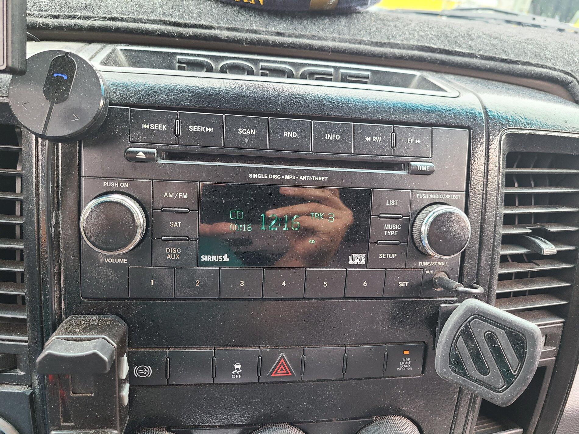

Hey all,
Just looking for some clarity. I dont know much about radios and double dins but I do understand the wiring and all the install stuff so just need some help.
my current radio in the image has stopped playing CD's and wont eject them anymore either. Does anyone know if this is a double din or not and if so have any recommendations on a good upgrade that has bluetooth or maybe apple and android play?
Just looking for options.
The sell replacement complete CD mechanisms that you can repair your radio with. Generally the gears crack and jam from age (or a belt rots off). There are several places that sell NOS or repaired OEM radios as well .

It is 1.5 DIN, a size that Chrysler used for decades.
You can drop in every Chrysler Radio that comes out of the same time yours is, even upgrade to the top of the line model like i always did. Its plug n play.
In your case that would be an 8.4 with touch screen, bluetooth, hands free phone and all the bells and whistles.
Probably, or do it yourself with ALFA, but that is guessing from my side.
I remember that in my '12 Durango I saw the settings for the Radio to choose which one is fitted.
