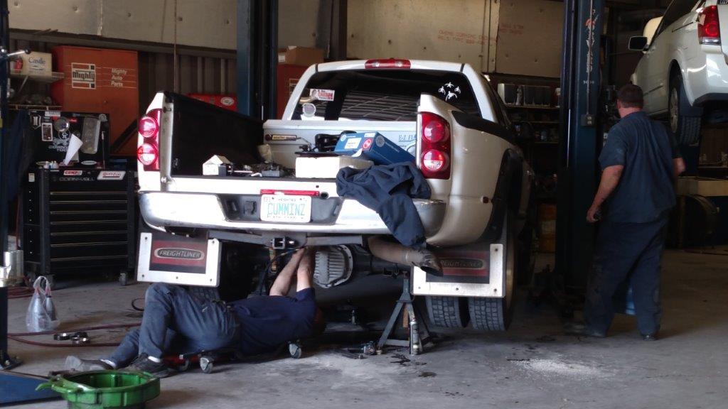

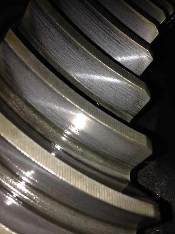

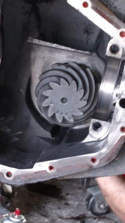

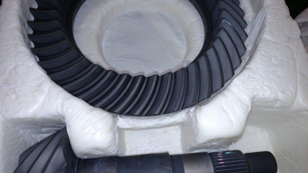

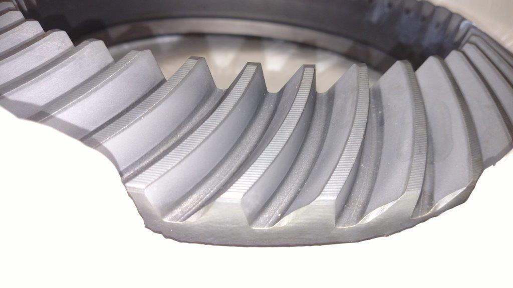

When we tore into rear diff we found a little wear on ring gear and pinion. Installed new carrier and ring gear and pinion and all bearings. Changed gears from 4.10 to 3.73
When running 4.10s @ 70mph I tacked @ 2,000rpm. I am kinda amazed that these gears and carrier gears are breaking up and wearing with only 92,000 miles.

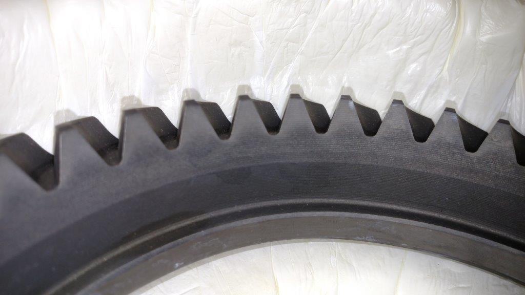

Here is a pic for comparison of my ring gear. 11 HO dually towing a combined 28K+ this pic is with 60-65K using AMZ/OIL 75-110 SevereGear.
