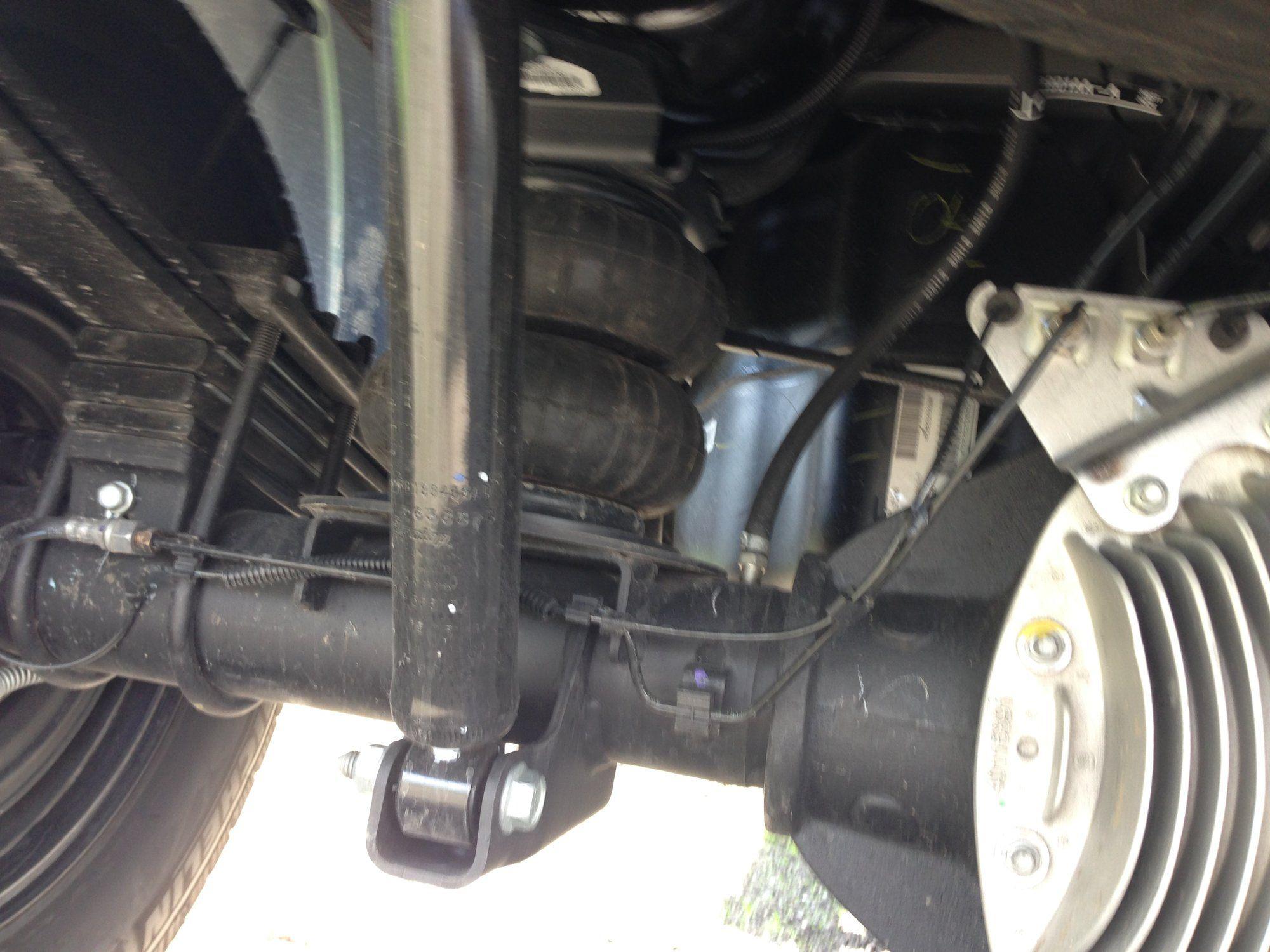

If towing heavy I would get this cover!

That's a nice large image of about 1/4 of your diff cover. Can you shoot another picture and attach a smaller image so I can click to my hearts content on the image?

The 3.42 DRW pickups w/AISIN and the 3.73 DRW pickups w/AISIN both have the aluminum cover.
All Max tow did was force 4:10's when I ordered my truck. It did add camers and 5th wheel hitch but u had already picked them separate. I see it also includes air suspension and I do not want that option. I wanted 3:73 so I did not order max toe. Mine came with finned cover. I thought it was in a dually rears
